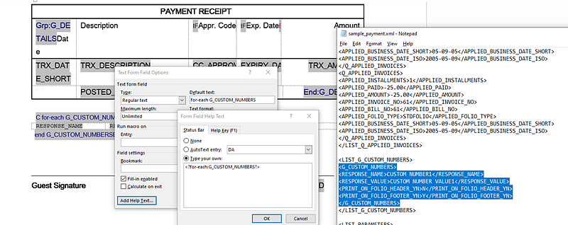

A Custom Numbers group is available in the XML of the sample_folio and sample_payment templates; refer to About Stationery Editor (Oracle Business Intelligence (BI) Publisher). You can insert the group into your customized template to generate the custom reference numbers on the folio or payment receipt.
Stored Custom Number(s) are also available in the Back Office Export views, EXP_BOF_CITYLED_RECORDS, EXP_FOLIOTAX, EXP_ALL_TRANSACTION_VIEW, and EXP_BOF_ALL_TRANSACTIONS with five separate columns for Custom_number1, Custom_number2, Custom_number3, Custom_number4, and Custom_number5. An additional Custom_numbers column with all stored custom numbers is available in a comma delimited string.

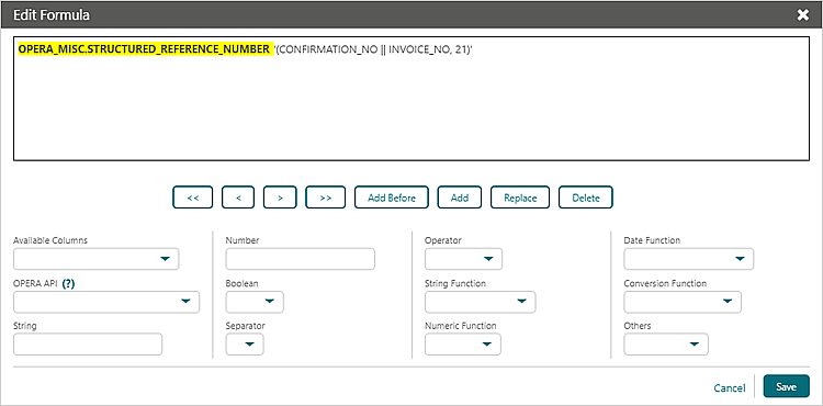

To create or edit SQL expressions, use the Edit Formula box or the Edit Condition box available in the Generation Details section of the Custom Numbers screen. These panels provide selectable values to build an SQL expression using String, Number, Date, Boolean, and conversion functions. You can also select from a list of SQL functions, separators, operators, and table columns (fields) such as ADDRESS1, ADDRESS2, ARRIVAL, BILLING_CONTACT_NAME, BIRTH_COUNTRY, and so on. These columns are a combination of data from Property details, Profile, Reservation, and Folio tax tables; they are specific to the reservation for which the custom number is being generated.Note:
To join multiple string elements together use the ‘||’ concatenation operator in your expression.Examples of Basic and Advanced Custom Number Formulas:
RESORT || '-' || DEPARTURE || '-' || CONFIRMATION_NO. Basic expression which generates a custom number that combines the property code, the departure date, and confirmation of a reservation; the resulting custom number could look like this: PROP1-04052020-780005823
OPERA_MISC.REFERENCE_NUMBER_WITH_WEIGHTS(INVOICE_NO,731,'BACK’)Advance expression which generates a custom number using the Reference Number with Weights function, based on the invoice number field, using 7-3-1 weights calculated from the back.

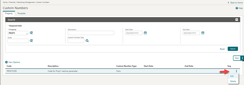

From the Administration menu, select Financial, select Cashiering Management, and then select Custom Numbers.
When the multi-property service is active, new custom numbers are created by selecting the Template tab. After creating the template, you can copy custom numbers to specific properties using the Copy action. For more information, see Copying Configuration Codes to Multiple Properties.Click New.

The Edit Formula dialog enables you to change the elements on a formula.

You can show or hide inactive custom numbers from your search by clicking the page level vertical ellipsis.From search results, click vertical ellipsis, and select Edit.
Update the available fields
Inactive. Select check box to mark this custom number inactive.
Click the pencil icons to update the Custom Number Formula or the Filter Condition.
