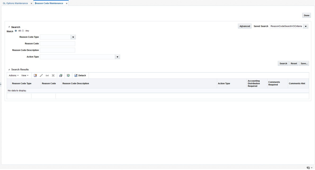

Search for a Reason Code
The Supplier Options window provides a way in which to search for already defined suppliers, supplier sites, or supplier groups.
Navigate: From the Tasks menu, select Foundation > Reason Code Maintenance. The Reason Code Maintenance window opens.
Figure 3-1 Reason Code Maintenance Window
  1. From the Reason Code Maintenance window, use the following criteria to search for existing reason codes:
    Table 3-1 Supplier Options Search Fields
    Field Description
    Reason Code Type
    The type of reason code for which you are searching. Valid values include:
    • Cost Discrepancy
    • Quantity Discrepancy
    • Tax Discrepancy (only in a Tax On environment)
    • Credit Note Tax Discrepancy (only in a Tax On environment)
    • RTV Chargeback
    Reason Code
    This field allows for query by reason code ID which is a unique identifier of the reason code being referenced.
    Reason Code Description
    This field allows for query by reason code description as a search/filter.
    Action Type
    This field allows filtering of Reason Codes based on the Action Type.
    The Action type drop-down has a dependence on the Reason Code type specified.
  2. After you have entered the desired search criteria, click Search.
    If you would like to save your search criteria to use at a later date, click Save.
    Your search results are displayed in the Search Results pane of the Reason Code Maintenance window.

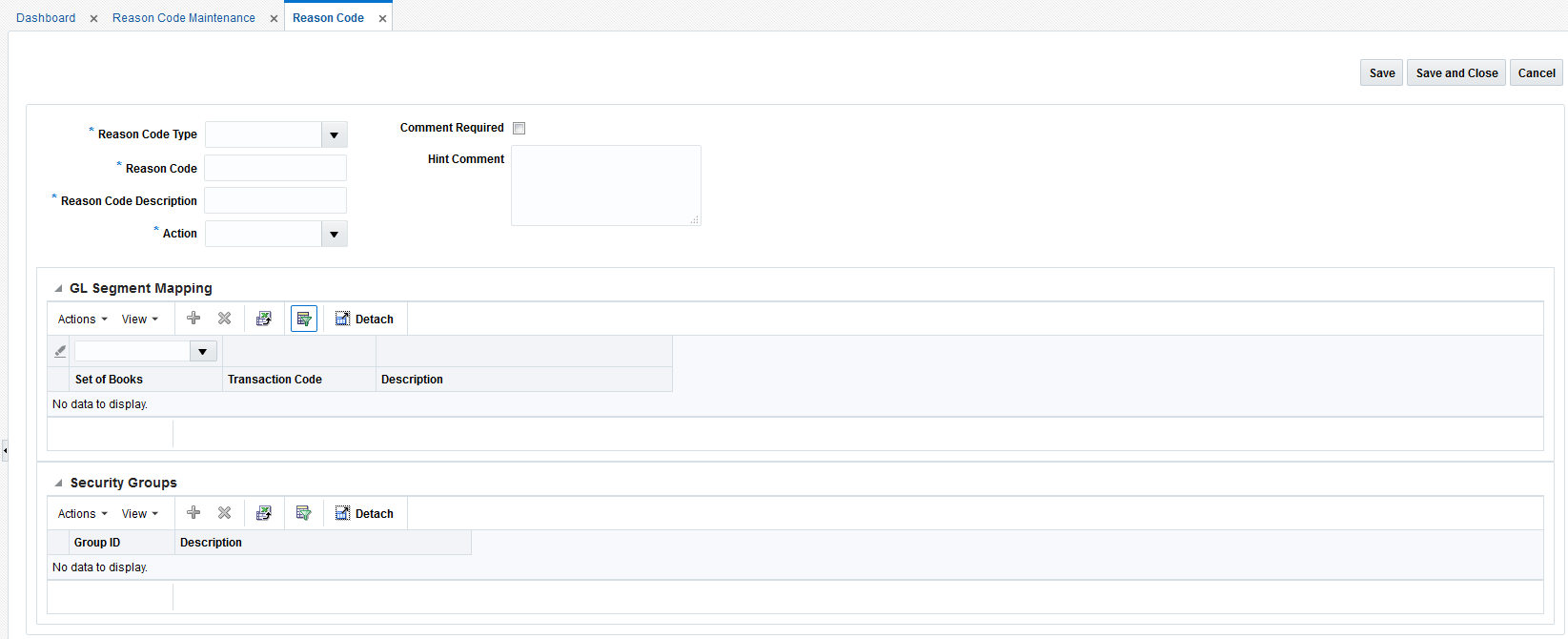

Create a Reason Code
Figure 3-2 Reason Code Maintenance Window
  1. From the Search Results pane of the Reason Code Maintenance window, select Create from the Action menu. The Reason Code window opens.
    Figure 3-3 Create Reason Code Window
  2. In the Reason Code Type field, select the reason code type to associate with the reason code. Valid values are:
    • Cost Discrepancy
    • RTV Chargeback
  3. In the Reason Code field, enter an ID for the reason code.
  4. In the Reason Code Description field, enter the description of the reason code.
  5. In the Action field, select the action to resolve the discrepancy.
  6. In the Comments Hint field, enter additional information that may be needed to resolve the discrepancy.
  7. If a comment is required when a reviewer is resolving the discrepancy, select the Comments Required check box.
  8. Click Save to save your changes and continue editing. Alternatively, from the drop down menu, select Save and Close to save your changes and close the window.
Associate General Ledger Segment Mapping with a Reason Code
The GL Segments Mapping pane is only enabled if the reason code type is one which requires accounting. For Reason Codes that require accounting, the GL cross-reference pane allows the user to specify the set of books and the GL cross reference transaction code to be used to post the accounting entries when this reason code is used in discrepancy resolution. For reason codes that do not require accounting, the GL Segments mapping container is disabled.
  1. In the Set of Books field, click the LOV button to select the Set of Books. The selected set of books GL options are displayed.
  2. In the Transaction Code field, click the LOV button to select a GL Transaction Code. This will be the Transaction Code used to send accounting entries to GL when this reason code is used.
    When the Transaction Code is selected, the screen will display the GL Cross reference segments assigned to this Transaction Code.
  3. Click Save to save your changes and continue editing. Alternatively, from the drop down menu, select Save and Close to save your changes and close the window.
Associate Security Groups with a Reason Code
Reason Code usage is controlled using the RMS security groups structure. The Security Groups pane maps user groups to a reason code. During discrepancy resolution, a user will only be able to see and use reason codes to which they have security access. Security access means that the user is in a security group which is mapped to the reason code.
Use the following procedure to associate a security group with a reason code:
  1. In the Security Groups pane, select Add from the Actions menu.
  2. In the Security Groups table, select the Security Group by ID or by Description.
