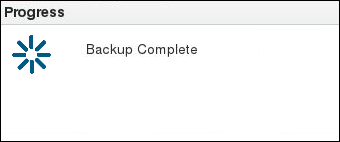

Set Initial Configuration Appears to Stall
When attempting to run "Set Initial Configuration" from the GUI, the operation may stall while displaying the following "Backup Complete" message:
Thsi screen capture shows the Backup Complete error message that displays if the system stalls after running Setup Initial Configuation.
Work-around: Refresh the browser, log back into the GUI, and run Set Initial Configuration again.
