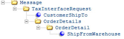

Tax Request Message (CWTaxRequest)
The tax request message contains order and tax information required for an external tax system to calculate tax.
Generated when? The system generates this message when tax needs to be calculated for an order during:

TaxInterfaceRequest

Tax Request Message: Sample XML
A sample of the Tax Request Message: Sample XML is presented below.
<Message time_created="05:56:37" date_created="2017-09-14" type=" " target="CWIntegrate" source="CWDirect">
<TaxInterfaceRequest sold_to_cust_class="" order_date="2017-09-14" order_shipto_nbr="001" order_nbr="00000270" company="076" request_type="QUOTATION">
<CustomerShipTo ship_to_country="US" ship_to_postal="01581" ship_to_state="MA" ship_to_city="WESTBORO" ship_to_addr1="1800 WEST PARK DRIVE"/>
<OrderDetails>
<OrderDetail odt_extended_price="000002250" odt_tax_override_amt="0000000000" odt_price="0002250" odt_qty="00001" odt_long_SKU_class="0100" odt_long_SKU_dept="0100" odt_arrival_date="2017-09-14" odt_item="GLASSWARE" odt_line_item_type="LM" odt_line_nbr="00001">
<ShipFromWarehouse ship_from_country="US" ship_from_postal="01701" ship_from_state="MA" ship_from_city="FRAMINGHAM" ship_from_addr1="100 MAIN STREET" ship_from_warehouse="001"/>
</OrderDetail>
<OrderDetail odt_extended_price="000001565" odt_tax_override_amt="0000000000" odt_price="0001565" odt_qty="00001" odt_arrival_date="2017-09-14" odt_item="GLASSWARE" odt_line_item_type="LD" odt_line_nbr="00001" odt_item_class="LD">
</OrderDetail>
</OrderDetails>
</TaxInterfaceRequest>
</Message>

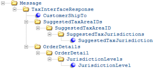

Tax Response Message: Sample XML
<Message date_created="Thu Sep 14 00:00:00 PDT 2017" type="CWTaxResponse" target="OROMS" source="Avalara">
<TaxInterfaceResponse order_addl_charge_seq="" tax_type="SalesOrder" order_shipto_nbr="1" order_nbr="270" entity="" company="76" request_type="QUOTATION">
<OrderDetails>
<OrderDetail odt_total_tax_rate="625" odt_total_tax_amt="141" odt_line_item_type="LM" odt_line_nbr="00001">
<JurisdictionLevels>
<JurisdictionLevel jurisdiction_level_tax_rate="625" jurisdiction_level_tax_amt="141000" jurisdiction_level_desc="MASSACHUSETTS" jurisdiction_level="STATE"/>
</JurisdictionLevels>
</OrderDetail>
<OrderDetail odt_total_tax_rate="625" odt_total_tax_amt="98" odt_line_item_type="LD" odt_line_nbr="00001">
<JurisdictionLevel jurisdiction_level_tax_rate="625" jurisdiction_level_tax_amt="98000" jurisdiction_level_desc="MASSACHUSETTS" jurisdiction_level="STATE"/>
</OrderDetail>
</OrderDetails>
</TaxInterfaceResponse>
</Message>
