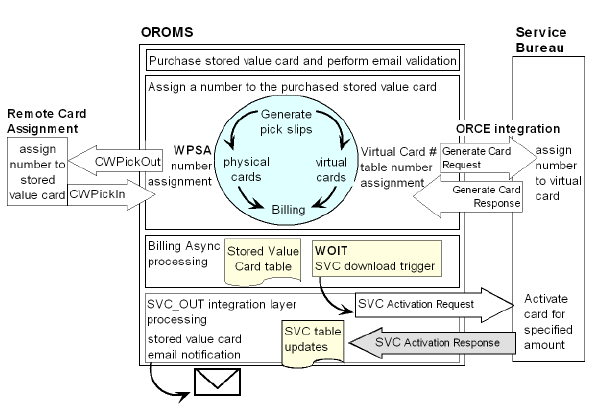

Stored Value Card Purchase and Activation
Purpose: You can purchase a stored value card item on an order to deliver to the recipient card holder by mail or email. However, before the recipient card holder can use the stored value card as a form of payment, the card must be activated by the service bureau.
Activation processing: To activate a stored value card:
1.
A customer purchases a stored value card item on an order. If the stored value card is a virtual card, the system verifies that an email address is defined for the recipient card holder. See Purchasing a Stored Value Card.
2.
During pick slip preparation, the system creates a separate pre-generated pick for each physical stored value card.
         After the picks are printed, you must:
-      Use Working with Physical Stored Value Card Assignment (WPSA) to assign a number to physical stored value cards by pick control number, OR
-      If you use an external system to assign numbers to physical cards, receive the card number in the CWPickIn XML Message.
See Assigning Numbers to Physical Stored Value Cards for additional details.
         For virtual stored value cards, during pick slip generation the system:
-      Assigns a number to the card from the Virtual Card Number Table (FLSVCA), OR
-      If you are using the Customer Engagement Stored Value Card Integration, assigns a number to the card by sending a Customer Engagement Generate Card Request to the Oracle Retail Customer Engagement system.
See Assigning Numbers to Virtual Stored Value Cards.
3.
Once the stored value card is billed (see Billing a Stored Value Card), the system generates an SVC download trigger containing the information required to activate the card.
4.
The system sends a stored value card activation request to the service bureau for activation.
         If the Use Activation / Reversal Batch Processing (I50) system control value is selected, the system does not process the SVC download trigger until you submit the batch process from the Transmitting Activation and Reversal Transactions (SSVC) menu option. In this situation, the SVC Activation integration layer job can remain inactive.
         If the Use Activation / Reversal Batch Processing (I50) system control value is unselected, when active, the SVC Activation integration layer job monitors for SVC download trigger records to process immediately.
See Activating a Stored Value Card.
5.
Once an approved stored value card activation is received from the service bureau, the system updates the stored value card and sends a Stored Value Card Notification Email to the customer, if defined, indicating the stored value card activation information.
Stored Value Card Activation Process:

For more information: See Activating a Stored Value Card for more information on processing the SVC download triggers.
The system creates an SVC download trigger in the IL Outbound Trigger table when a stored value card item is billed (see Billing a Stored Value Card).
Identifying SVC Download Triggers
You can view all download triggers in the IL Outbound Trigger table at the Work with Outbound Interface Transactions Screen.
Each SVC download trigger in the IL Outbound Trigger table contains a:
         File code: indicating the type of information to download and which IL process job processes the trigger. For SVC download triggers, the File code is SVC.
         Key: indicating the specific record to download. For SVC download triggers, the Key identifies the specific company, order number, ship to number, order detail sequence number, and stored value card sequence number associated with the SVC download trigger. For example, the Key 555000066760010000100004 indicates the stored value card information is located in company 555 for order number 6676, ship to number 1, order detail sequence number 1, and stored value card number 4.
         Capture type: indicating the type of activity performed against the record. SVC download triggers are always capture type A indicating the stored value card was created.
SVC download triggers in a ready status are processed by the SVC_OUT integration layer job.
File code
Refers to table
Key
IL Process job
SVC
Stored Value Card
111222222223334444455555 where:
111 is the company code
22222222 is the order number
333 is the ship to number
44444 is the order detail line sequence number
55555 is the stored value card sequence number
SVC_OUT
Generating the Stored Value Card Activation Request
To generate a stored value card activation request, the system:
1.
Creates an SVC download trigger when an order containing a stored value card item assigned a number is billed; see Identifying SVC Download Triggers.
2.
Looks for unprocessed SVC download triggers to process, based on the setting of the Use Activation / Reversal Batch Processing (I50) system control value.
         If this system control value is selected, the system does not process the stored value card trigger records until you submit the batch process using the Transmitting Activation and Reversal Transactions (SSVC) menu option or the SVCACT periodic function (program name PFR0076). In this situation, the SVC Activation integration layer job can remain inactive.
         If this system control value is unselected, when active, the SVC Activation integration layer job monitors for stored value card download trigger records to process at defined intervals, based on the Outbound delay time.
The system:
         looks for SVC download triggers with the File code SVC and a status of ready (R).
         determines which stored value card activation to download, based on the Key field for the activation download trigger.
         looks for a record in the Stored Value Card Table that contains this information.
3.
Looks at the Stored Value Card Activation Authorization Service (I26) system control value to determine the service bureau used to activate stored value cards.
4.
Looks at the Communication type field for the service bureau to determine how transactions are processed between Order Management System and the service bureau.
         Integration Layer = The system sends activation transactions to the service bureau using the queues defined for the activation integration layer job.
         Payment Link = Point-to-point integration. The system sends activation transactions to the service bureau using a point-to-point integration. You must define communication settings in Working with Customer Properties (PROP). The system does not use the activation integration layer job to communicate with the service bureau; however, the system uses the job to process activation triggers. See Process Activations Using Payment Link Communication.
If the Communication type field for the service bureau is Payment Link:
         Order Management System uses the settings in Working with Customer Properties (PROP) to send the activation request directly to the service bureau in the format of the other system.
         The service bureau receives the activation request, processes the activation, and sends a response back to Order Management System.
See Processing Authorizations and Deposits Using Point-to-Point Communication for a list of integrations that support point-to-point communication.
5.
Order Management System processes the activation response accordingly. See:
         What Happens When the Stored Value Card Activation is Approved?
         What Happens When the Stored Value Card Activation is Declined?
A stored value card receives an approved activation if the activation response contains an authorization number. In this case, the system:
         updates the associated record in the Integration Process Control table to CMP complete (if the Communication type field for the service bureau is Integration Layer).
         updates the associated record in the Stored Value Card Table with the activation date, activation time, and activation response.
         generates a Stored Value Card Notification Email and sends the email to the recipient card holder.
You can review the activated stored value card at the Display Stored Value Cards Screen. The activated stored value card number will have an Activation date, time, and response. Additionally, if a Stored Value Card Notification Email was sent, the Email sent field will display the date the email was sent to the customer.
Note:             If you receive a declined stored value card activation response after you have already received an approved response, the system does not deactivate the stored value card; the card remains activated and available to use as payment.
If a customer returns a stored value card or reports the card stolen: If a customer returns a stored value card or reports the card stolen, you must call the service bureau to deactivate the card.
The system sends a Stored Value Card Notification email or XML message to the recipient card holder when the SVC_OUT job processes an approved stored value card activation request and:
         The SVC type field for the stored value card item is E (physical card with notification) or V (virtual card).
         An email is defined for the recipient card holder. The system uses the Stored Value Card Email Hierarchy to determine the email address used to send a Stored Value Card Notification email to the stored value card recipient.
         The Stored Value Card Email Notification Program (I30) system control value specifies a valid program name.
A separate email is sent for each unit of a stored value card item ordered. For example, if a customer purchases a stored value card for a quantity of 2 to send to a recipient customer, the recipient card holder receives 2 stored value card emails.
Note:             Credit card encryption allows you to encrypt the stored value card number in the Order Management System database. If you use credit card encryption, the stored value card number will be unencrypted and unformatted in this email since the customer needs to read the stored value card number for future purchases. See the Data Security and Encryption Guide for an overview.
Order history message: The system writes an order transaction history message, indicating a stored value card notification was sent to the stored value card recipient customer: SVC Notice to bmiranda@att.net.
For more information: See Working with E-Mail Notification Templates (WEMT) for more information on how the system generates email notifications, and see Stored Value Card Notification Sample and Contents for a sample email message. Also, see the Outbound Email API for information on when the system generates the Outbound Email XML Message (CWEmailOut) instead of an email, and the XML message layout.
A stored value card receives a declined activation if the activation response does not contain an authorization number. In this case, the system:
         updates the associated record in the Integration Process Control table to FLD error (if the Communication type field for the service bureau is Integration Layer).
         creates a SD tickler if you Use Workflow Management (H96), indicating the stored value card activation request was declined. See SD (SVC Activation Decline) Event Processing for more information on how to resolve this tickler.
         includes the order containing the declined stored value card on the Unactivated Stored Value Card Report. This report prints when you run the Unactivated Stored Value Cards periodic function (program name PFR0075).
         does not send a Stored Value Card Notification Email to the customer, since the stored value card was not activated.
You can review the declined stored value card at the Display Stored Value Cards Screen. The declined stored value card number will have an Activation response, but a blank Activation date and time.
To activate a declined stored value card: You must call the service bureau to activate the card. You cannot re-send an activation request to the service bureau.
