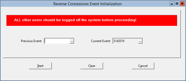

To reverse concessions event initialization:
Figure 2-28 SimVen Vending Utility (Reverse Concessions Event Initialization)
This figure displays the Reverse Concessions Event Initialization window
All other users should be logged off of the system prior to proceeding.
  1. On the toolbar, click System/Utilities, clickUtilities, and then click SimVen Vending Utility.
  2. Click the ... button to select the Previous Event from the Event Calendar Selection List.
  3. Click Ok.
  4. Click Start to initialize the process.
