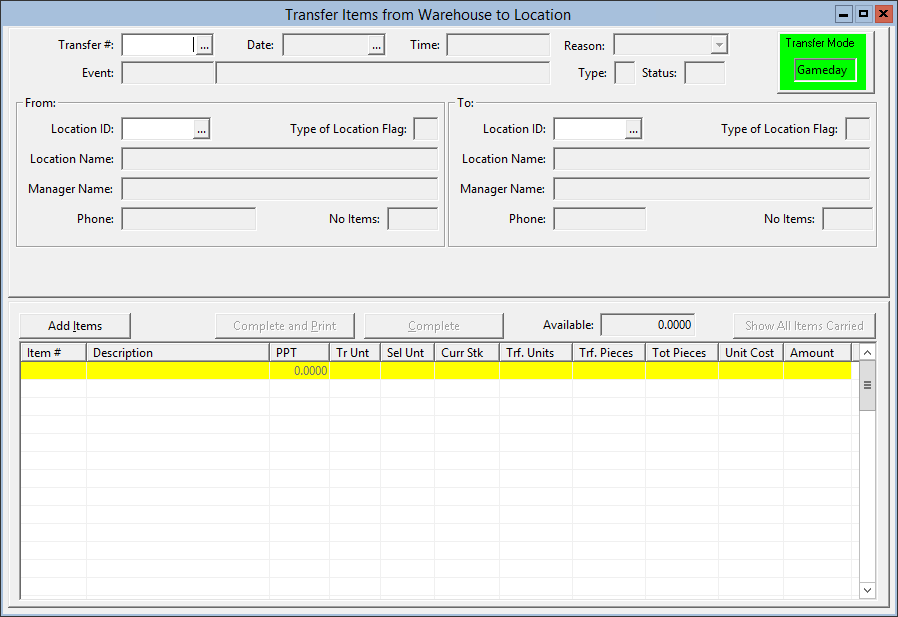

Transferring from Warehouse to Location
You can transfer products from the warehouse to remote inventory locations before and during an event. Leave the Transfer # field blank as SimVen automatically assigns a transfer ID.
Figure 1-41 Transfer from Warehouse to Location
This figure displays the Transfer Item from Warehouse to Location window.
  1. On the toolbar, click Warehouse, click Transfers, and then click Transfer From Warehouse to Location.
  2. If the Transfer Items From Warehouse To Location window contains information, click Clear All.
  3. Select the Reason for the transfer, and if you want to transfer products from another warehouse other than the main warehouse, select the Location ID of the transferring warehouse.
  4. Select the Location ID of the receiving location.
  5. To see all items carried at the receiving location on the transfer list, click Show All Items Carried.
  6. To individually add items carried at the receiving location to the transfer list:
    1. Click Add Items, select an item, and then click OK.
    2. Repeat Step 6-a until all the items you want to transfer appear on the list.
  7. Enter the bulk quantity to transfer in the Trf. Unit column for the relevant items.
    Look at the pieces per transfer unit or PPT value when determining the quantity to transfer. If you transfer a large quantity (more than 100,000 pieces), contact Oracle Customer Support.
  8. To transfer part of a transfer unit, enter the partial quantity to transfer in the Trf. Pieces column for the relevant items.
  9. Click Complete or click Complete and Print to print two copies of the Inventory Transmittal slip.
