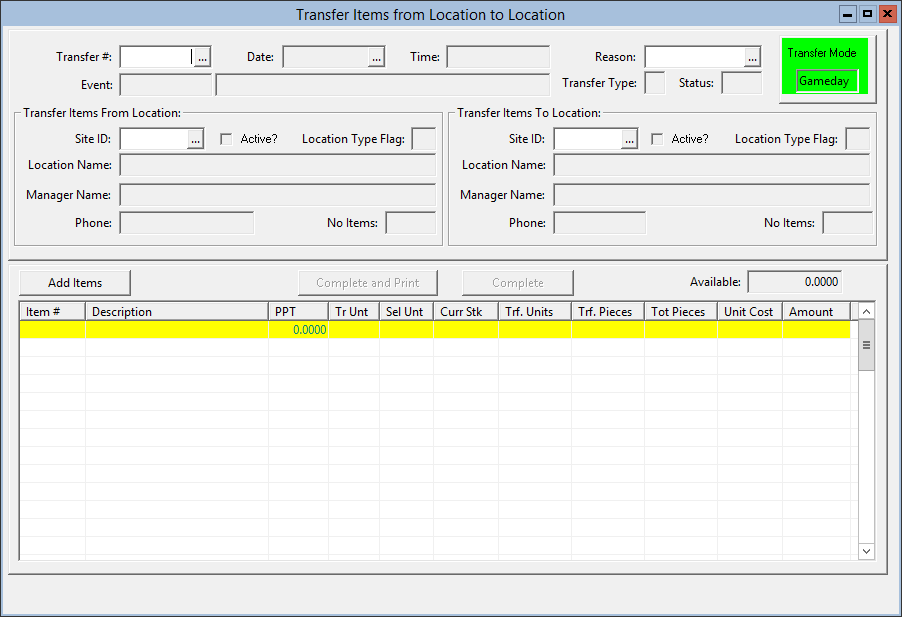

You can transfer products from one inventory location to another during an event. The transfer can only occur in Game Day mode, and both locations must have the items that you want to transfer. Inventory levels change in real time.
Leave the Transfer # field blank as SimVen automatically assigns a transfer ID.
Figure 1-42 Transfer from Location to Location
This figure displays the Transfer Items from Location to Location window.
  1. On the toolbar, click Warehouse, click Transfers, and then click Transfer From Location.
  2. If the Transfer Items From Location To Location window contains information, click Clear All.
  3. Select the Reason for the transfer, select the Site ID of the transferring location, select the Site ID of the receiving location, and then click the Item # header column.
    The list only shows the items that are carried at the receiving location.
  4. Enter the bulk quantity to transfer in the Trf. Unit column for the relevant items.
    Look at the pieces per transfer unit or PPT value when determining the quantity to transfer. If you transfer a large quantity (more than 100,000 pieces), contact Oracle Customer Support.
  5. To transfer part of a transfer unit, enter the partial quantity to transfer in the Trf. Pieces column for the relevant items.
  6. To add items to the transfer list, click Add Items, select an item, and then click OK.
  7. Click Complete or click Complete and Print to print two copies of the Inventory Transmittal slip.
