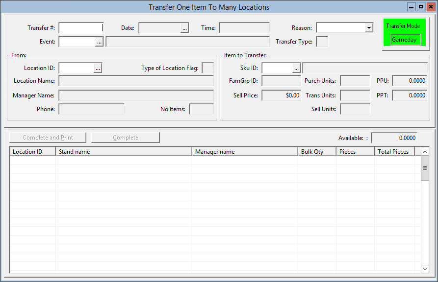

Figure 1-43 Transfer One Item to Multiple Locations
This figure displays the Transfer One Item to Many Locations window.
  1. On the toolbar, click Warehouse, click Transfers, and then click Transfer One Item to Many Locations.
  2. If the Transfer One Item To Many Locations window contains information, click Clear All.
  3. Select the Reason for the transfer, select the Location ID of the transferring warehouse, select the Sku ID (menu item number) of the item to transfer, and then press the Tab key.
  4. Enter the Bulk Qty. or the Pieces to transfer for each inventory location, and then click Complete, or click Complete and Print to print two copies of the Inventory Transmittal slip for each location receiving the stock.
