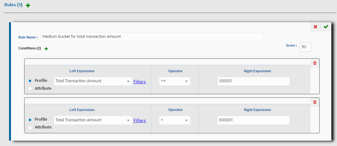

High bucket for total transaction amount |
If Total Transaction Amount >= 500001, then Score is 50. |
Medium bucket for total transaction amount |
If Total Transaction Amount >= 100001 and Total Transaction Amount < 500001, then Score is 20. |
Lower bucket for total transaction amount |
If Total Transaction Amount >= 50000 and Total Transaction Amount < 100001, then Score is 20. |

Rules are logical comparisons against conditions that result in a score.
To add a rule, follow these steps:
1. Navigate to the Rules section of the Scoring page.
2. Enter a name for this rule.
3. Enter a score for this rule.
4. Define the conditions. You can add multiple conditions.
· Left Expression: Select the expression on which rule must be operated. The following two types are available:
§ Profiles: are an aggregation of information. Profiles can be based on different grouping entities and can be filtered to only look at kinds of transactions. By default, Event Count, Total Transaction Count and Total Transaction Amount profiles are available. You can also use filters on profile. For more information, see Adding Filters.
§ Attributes: this list is the group of data condition such as correlation, generated events, and so on.
§ Operator: select the operator from the Operator drop-down list for the expression and also the expression that it is to be operated on. The available operators are IN, =, >, <, <=, >=, and <>.
· Right Expression: Provide the value on which the left expression and operators will work.
5. Click Save
to
save the Rule.

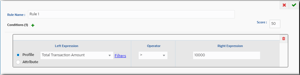

The following example shows how to create a rule based on the Total Transaction Amount and Jurisdiction conditions:
Event 1: Total Transaction Amount = 17500, Jurisdiction code = AMEA
Event 2: Total Transaction Amount = 4000, Jurisdiction code = INDA
Event 3: Total Transaction Amount = 5000, Jurisdiction code = EMEA
· Define a rule (Rule 1) with the score 50 based on the following conditions:
§ Conditions: When Total Transaction Amount > 10000
§ Result: Event 1 and Event 2 will be assigned a score as 50.

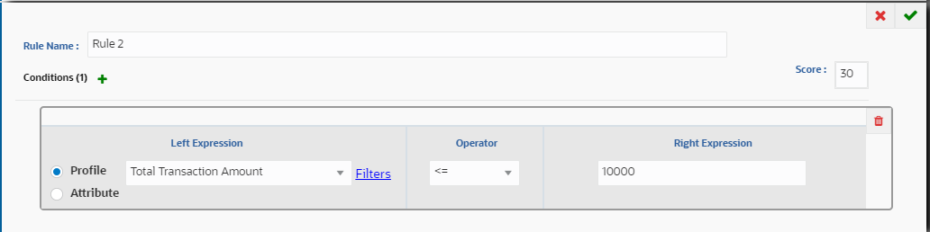

· Define a rule (Rule 2) with the score 30 based on the following conditions:
§ Conditions: Total Transaction Amount < = 10000

The Rules window is displayed. Enter the Rule Name and Score as 50.
2. Define the condition (Condition 1) as Total Transaction Amount >10000.
Example of Event Scoring – Rule 1
3. Click Save

Enter the Rule Name and Score as 30.
5. Define the Condition 1 as Total Transaction Amount < = 10000.
Example of Event Scoring – Rule 2
6. Click Save
