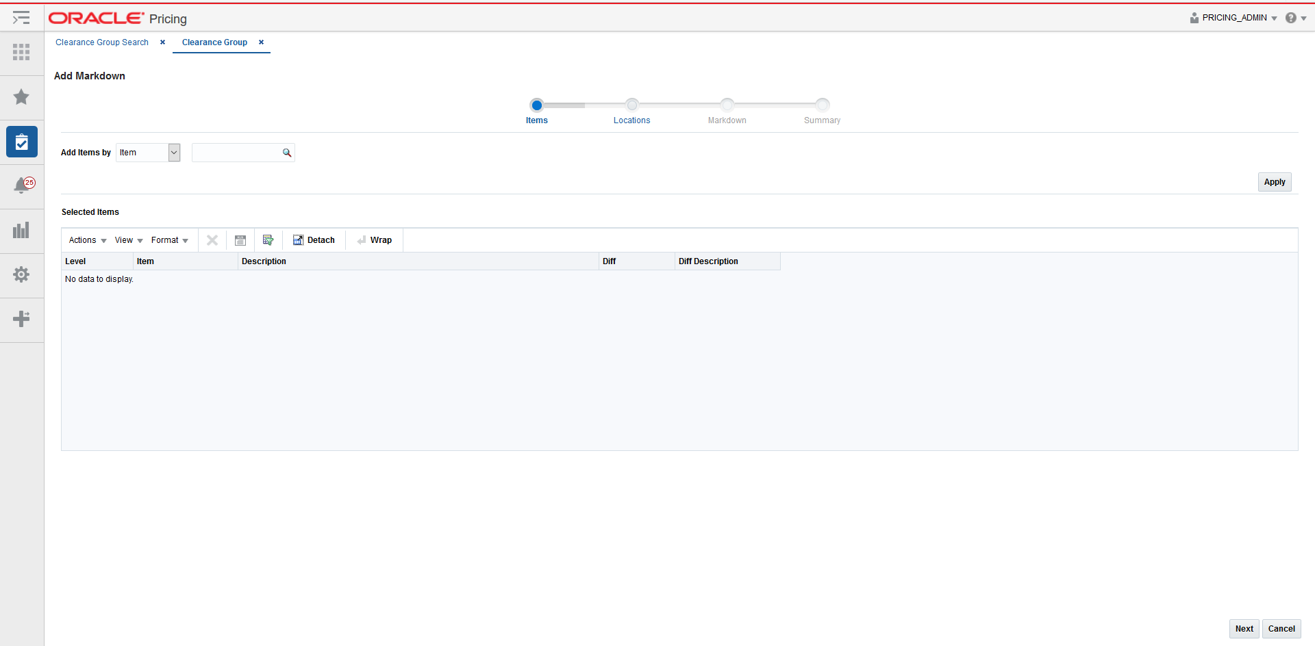

The initial page in the Markdown Wizard allows you to select the items that you want to add to the markdown.
From the Item Markdowns table, select Add from the Actions menu
The Add Markdown Wizard launches.
From the Add Markdown Items page, enter the items to add to the new markdown using the following criteria:
| Field | Description |
 Add Items by  |
 The Add Items by field allows you to select a category by which you can narrow the list of things to add to the markdown. Options are:
 Item  |
 The Item field is active if you select Item in the Add Items by field. Click the magnifying glass to search for an item to add to the markdown.  |
 Parent/Diff  |
 When Parent/Diff is selected for 'Add Items by' the display of the screen changes, showing an item field and diff type field as the top row, with a Diffs table directly below. Entering an Item and Diff type will populate the diff table where diffs can then be selected. Combinations of the entered parent item and the selected diffs are added to the Selected Items table when the apply button is selected.  |
 Diff Type  |
 The Diff Type field is active if you select Parent/Diff in the Add Items by field.  |
 Item List  |
 The Item List field is active if you select Item List in the Add Items by field. Click the dropdown to select a defined list of items to add to the markdown.  |
 Source File  |
 Source File is active if you select Upload List in the Add Items by field. Click Browse to select the file to upload.  |
Once you have entered your criteria, click Apply to move entered or selected data for the item selection option to the Selected Items table. In the case of an Item List or Upload List, the items in the list are populated into the Selected Items table. Once all your items are added to the markdown, click Next. The Add Markdown Locations page appears. Continue with Add Locations.

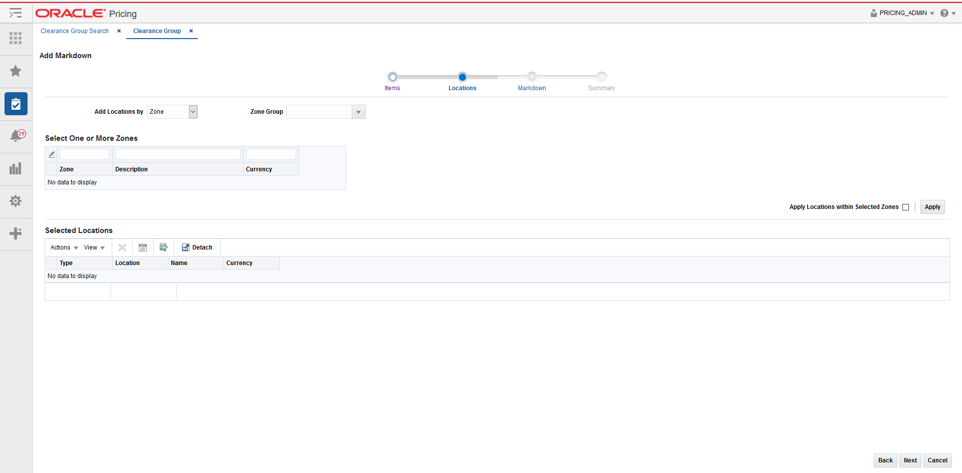

The Locations page of the Markdown Wizard allows you to define the locations associated with the markdown.
From the Add Markdown Location page, select the location type you want to use for adding locations using the following criteria:
Table 2-2 Locations Page Fields
 Add Locations by  |
 The Add Locations by field allows you to select a category by which you can narrow the list of locations to add to the markdown. Options are:
 Note: The Warehouse option is only displayed if the Recognize Warehouses as Locations system option is set to Yes.  |
 Zone Group  |
 The Zone Group field is active if you select Zone in the Add Locations by field.  |
 Zone Table  |
 The Zone Table is active if you select Zone in the Add Locations by field. When a zone group is entered, the Zone Table will be populated with the zones in the zone group.  |
 Apply Locations within Selected Zones  |
 The Apply Locations within Selected Zones check box is active if you select Zone in the Add Locations by field. This checkbox allows exploding the zone into stores and warehouses for populating the Selected Locations table. If you have access to one location in a zone, you can create events for the entire zone and markdowns can be created for all locations under the zone after exploding the zone.  |
 Location List  |
 The Location List dropdown list is active if you select Location List in the Add Locations by field. Click the dropdown to select from a defined list of locations to add to the markdown.  |
 Store  |
 The Store dropdown list is active if you select Store in the Add Locations by field. Click the dropdown to select from a defined list of stores to add to the markdown.  |
 Warehouse  |
 The Warehouse dropdown list is active if you select Warehouse in the Add Locations by field. Click the dropdown to select from a defined list of warehouses to add to the markdown.  |
From the search results pane, select the location(s) to add to the markdown and click Apply.

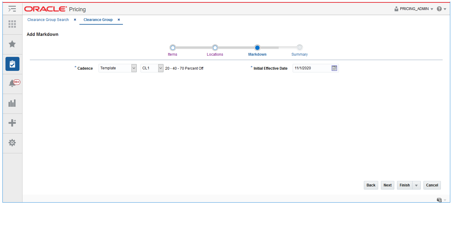

 Cadence  |
 This field is used to decide whether a single markdown or multiple markdowns will be created for each item/location combination based on the cadences in the template. The options are:
 When Template is selected, the wizard will create multiple markdowns for the item/locations selected based on the number of markdowns defined in the template.  |
 Template  |
 Select the template you which to use to generate multiple markdowns for the item/location combinations selected. This field only shown in the Cadence Template view of the Add Markdown screen.  |
 Initial Effective Date  |
 Enter the date on which you want the first markdown of the cadence template to take effect. The effective date of subsequent markdowns is based on the initial effective date plus the days after first markdown parameter from the template. This field only shown in the Cadence Template view of the Add Markdown screen.  |

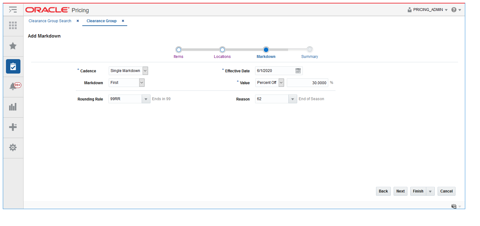

 The fields described below are only shown on the Single Markdown view of the Add Markdown screen.  |
 Markdown  |
 The Markdown field contains a predefined identifier for the Markdown to describe what the new markdown represents in the clearance lifecycle. For example, this could be first, second, final, and so on. This field can be left blank, if not required by a system option setting.  |
 Value  |
 The Value field provides the options that derive the new retail price. If a system option default has been defined, a value will be automatically added for your event. But this can be changed, if desired. Options are:
 After selecting the change type, you will enter the actual value for the change. This field is required entry for every change type. The field supports up to four decimal places for Percent Off value. For Amount Off and Fixed Price decimal placement is based on currency of selected locations.  |
 Effective Date  |
 The date on which the markdown is set to take effect. You have the option to key in a date or select one using the calendar widget.  |
 Rounding Rule  |
 The Rounding Rule field provides the ability to smooth retails for an item or location. If a system option default has been defined, a value may be automatically added to your event. But, this can be changed or removed, if desired.  |
 Reason  |
 The Reason value defines the reason the markdown is being created. If a system option default has been defined, a value may be automatically added to your event. But, this can be changed or removed, if desired.  |

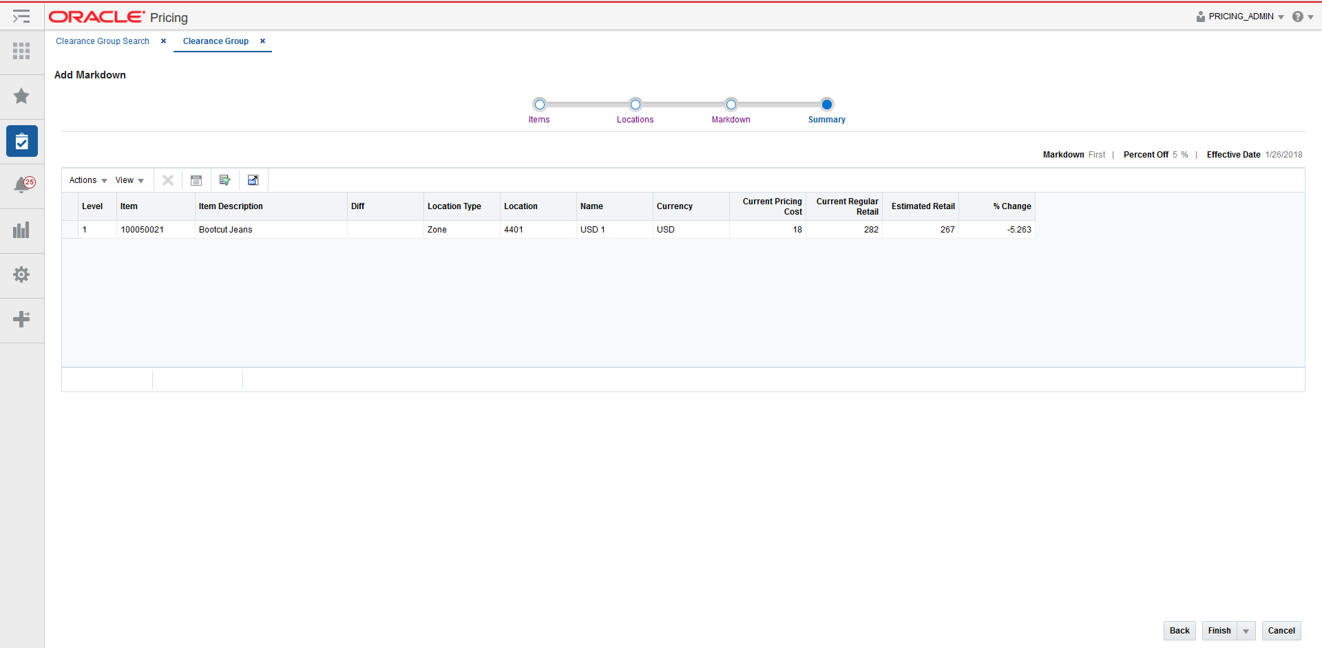

Once all your markdown information is entered, click Next. The Add Markdown Summary page appears. Continue with Review, Submit and Approve.
If you want to skip the Summary Page, you can click on Finish or select Submit, or Approve options from the Finish drop down menu.
The Summary page displays the details of the markdown before it is added to the Clearance Group.
Confirm the markdown settings and click on Finish or select Submit or Approve from the Finish drop down menu. You are returned to the Clearance Group screen. Your new markdown events are listed in the Item Markdowns table.
The Summary Page also allows individual markdowns to be removed before they are added to the Clearance Group.Whenever a clearance is approved, it will be subject to the conflict checking process. A clearance markdown may also be subject to conflict checking when it is submitted, depending on the system option settings. This ensures that invalid prices, or prices out of alignment with your pricing strategy, are not sent down to the selling solutions.

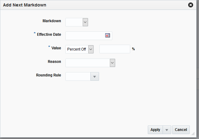

From the Clearance Group page, highlight the item markdown in the Item Markdowns table to which you want to add an additional markdown and select Add Next Markdown from the Action menu. The Add Next Markdown pop-up appears.
 Markdown  |
 Effective Date  |
 The date on which the clearance is set to take effect. You have the option to key in a date or select one using the calendar widget.  |
 Value  |
 Reason  |
 Rounding Rule  |
Once values are specified, click Apply, Submit, or Approve. The Add Next Markdown pop-up closes and you are returned to the Clearance Group page.

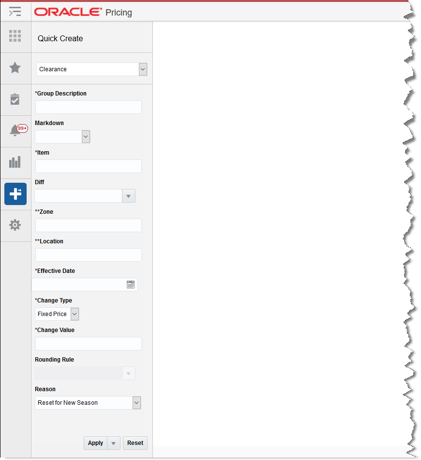

Quick Create provides an alternative method for creating a markdown. It is best suited for small sets of items and locations - such as a single item in one or two zones. Perform the following procedure to create a clearance using this function.
From the Pricing Tasks list, click the Quick Create icon.
The Quick Create pane appears.
From the Quick Create pane, select Clearance from the Quick Create drop down list.
Enter information for the following fields:
Fields marked with an Asterisk are required. Fields marked with a double asterisk means that one of the fields needs to be entered.Table 2-6 Clearance Quick Create Fields
 Group Description  |
 This field allows for entry of a description that will be used to create a new clearance group.  |
 Markdown  |
 Item  |
 Diff  |
 The Diff field allows for entry or selection of a single Diff Value. You have the option to use the list of values to search on Diff Type to find the Diff value.  |
 Zone  |
 The Zone field allows for entry of a zone within a single zone group. You may enter a single zone or multiple zones. If multiple zones are entered a semicolon is used to separate values. Note: Either a Zone(s) or Location(s) must be entered, but not both.  |
 Location  |
 The Location field allows for entry of a location. You may enter a single location or multiple locations. If multiple locations are entered a semicolon is used to separate values. Note: Either a Zone(s) or Location(s) must be entered, but not both.  |
 Effective Date  |
 Change Type  |
 The Change Type field provides the options that will derive the new retail price. There is a system option default that may display for the Change Type if it exists. The default value can be overridden. Change Type options are:
 Change Value  |
 The Change Value field contains the change by percent, change by amount, or fixed price value depending on the change type selected.  |
 Rounding Rule  |
 Reason  |
Once you have entered all information for the newly created price change record, click Apply, Submit, or Approve. The new clearance is created.
If you select Apply, the Clearance Group will be opened so that you can review and approve the event from that page. Otherwise, the event is created and subjected to submit and approval validations in the background.
