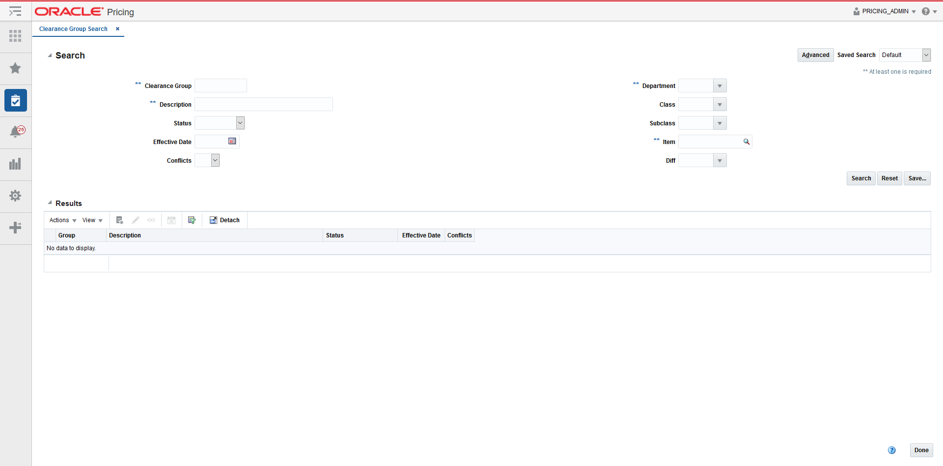

Perform the following procedure to search for an existing clearance group.
From the Tasks menu, select Manage Clearance Groups under Clearances. The Clearance Group Search page appears.
Enter your clearance search criteria using the following fields:
In order to conduct a clearance search, you must enter at least one of the following; Department, Clearance Group, Description, or Item.Table 4-1 Clearance Search Fields
Field | Description |
Clearance Group |
The Clearance Group field allows you to enter a group ID to be used in search criteria. |
Description |
The Description field allows you to enter a partial description to be used in search criteria. |
Status |
The Status field allows you to select a status to be used in search criteria. Values for the drop down include: Worksheet, Submitted, Approved, Rejected, Executed, and Processing. |
Effective Date |
The Effective Date field allows you to enter or select an effective date to be used in search criteria. |
Conflicts |
The Conflicts field allows you to select one of the following values; Yes, No or NULL (Blank) to be used in search criteria. |
Department |
The Department field allows you to enter or select a department to be used in search criteria. The department list of values queries all departments. |
Class |
The Class field allows you to enter or select a class to be used in search criteria. The class list of values queries all classes or all classes for the entered Department. |
Subclass |
The Subclass field allows you to enter or select a Subclass to be used in search criteria. The subclass list of values queries all subclasses or all subclasses for the entered class. |
Item |
The Item field allows you to enter or select an item(s) to be used in search criteria. You have the option to go directly to the search icon to look up items. |
Diff |
The Diff field allows you to enter or select a diff value to be used in search criteria. The diff list of values includes both diff type and diff value. |
Once your search criteria are entered, click Search. The search results are displayed in the Results pane.

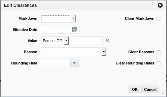

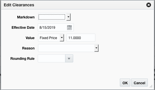

From the Clearance Group page, you can select either item markdowns or locations to edit. Highlight the item markdown or location you want to edit (locations shown are associated with the row in the item markdown table which has focus) and select Edit from that table's Action menu. The Edit Clearances pop-up appears. If you wish to modify multiple rows, click on each row to be updated while holding down the Ctrl or Shift button to multi-select.
If more than one row is selected for update, then check boxes for clearing the markdown, reason code and rounding rules will appear. Selecting these options will remove the appropriate attribute from the selected events.From the Edit Clearances pop-up, use the following fields to edit the clearance details:
When multiple clearances are selected for editing, fields in the popup may show up as empty. This indicates that the value may vary across the selected clearances. Entering a value and updating will update all the rows, leaving the value empty will leave the values unchanged on the individual clearances.Table 4-2 Edit Clearances Fields

Effective Date |
The date on which the clearance is set to take effect. You have the option to key in a date or select one using the calendar widget. |
Value |
The Value field provides the options that derive the new retail price. You have the option to modify the Change Type value. Change Type options:
After selecting the change type, you will enter the actual value for the change. This field is required entry if a change type is selected. The field supports up to four decimal places for Percent Off value. For Amount Off and Fixed Price decimal placement is based on currency of selected locations. |

Clear Reasons |
The Clear Reasons checkbox displays next to the Reasons field when multiple items or locations are selected for edit. If you choose to remove a Reason code for the select clearances the Clear Reasons checkbox can be clicked and the reason will be removed from the selected events. |
Clear Rounding Rules |
The Clear Rounding Rules checkbox displays when multiple items or locations are selected for edit. When the Clear Rounding Rules checkbox is clicked the value for the rounding rule is removed from the selected events. |
Clear Markdown |
The Clear Markdown checkbox displays when multiple items or locations are selected for edit. When the Clear Markdown checkbox is clicked the value for the Markdown field is removed from the selected events. |
Once updates are complete on the Edit Clearances pop-up, click OK. The Edit Clearances pop-up closes and you are returned to the Clearance Group page.

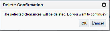

From the Clearance Group page, you can select one or more items or locations to delete. Highlight the items or locations you want to delete and select Delete from that table's Action menu. The Delete Confirmation message appears.
Click OK to confirm the deletion. You are returned to the Clearance Group page.
