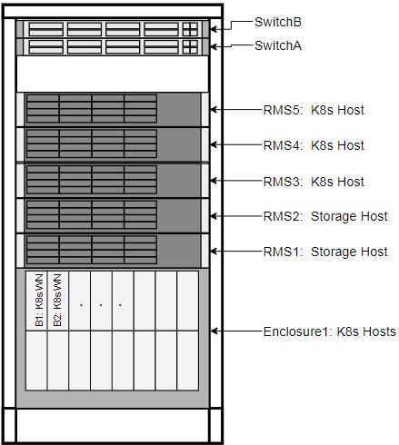

Confirm hardware components are installed in the frame and connected as per the tables below
Figure B-1 Rackmount ordering
OCCNE frame installation is expected to be complete prior to executing any software installation. This section provides reference to prove the frame installation is completed as expected by software installation tools.
