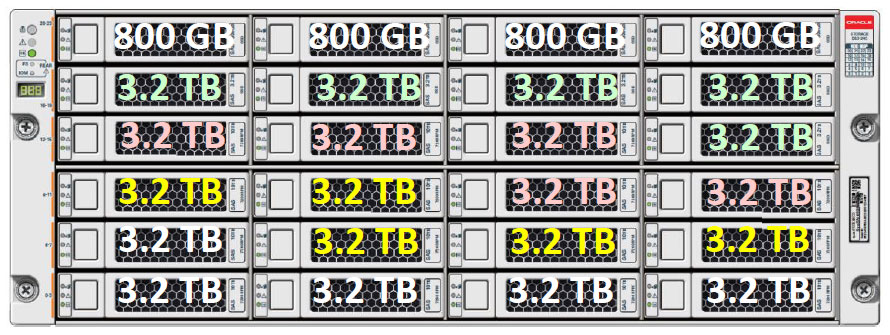

  • The Oracle Database Appliance X7-2-HA storage shelf partially-populated base configuration supports 15 expansion slots for either 3.2 TB SSDs (available in five-packs) or 10 TB HDDs (available in a fifteen-pack). These expansion slots are labeled 5-19 as seen from the front of the system (callouts 5 through 19 in the following illustration).
    Note the following:
    • Expanding the base configuration storage shelf with 3.2 TB SSDs can be performed with the appliance running. The base configuration has slots 20-23 populated with 800GB drives for REDO and slots 0-4 with 3.2 TB drives for DATA/RECO. Expansion drives are available in five-packs and are populated in shelf storage slots from the bottom up to be used for DATA/RECO, as follows:
      • The first five expansion drives go into slots 5-9.
      • The second five expansion drives go into slots 10-14.
      • The third five expansion drives go into slots 15-19.
      The following illustration shows the expanded drive configuration for 3.2 TB SSDs.
      When you expand storage, you must first install all of your expansion disks (5, 10 or 15). Once you expand storage to support additional disks, you cannot revert to the base configuration (no drives in slots 5-19).

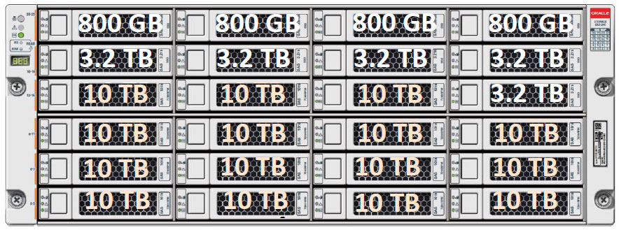

    • Expanding the base configuration storage shelf with 10 TB HDDs requires that you first power down the appliance. The base configuration has slots 20-23 populated with 800GB drives for REDO and slots 0-4 with 3.2 TB drives for DATA/RECO. Expansion drives are available in a fifteen-pack and are populated in the storage shelf as follows:
      • Move the 3.2 TB DATA/RECO drives from shelf storage slots 0-4 to slots 15-19. These will be used for FLASH after redeployment.
      • Install the fifteen 10 TB HDD expansion drives into slots 0-14. These will be used for DATA/RECO after redeployment.
      The following illustration shows the expanded drive configuration for 10 TB HDDs.
      After adding the storage, power on the appliance to perform cleanup, redeploy the appliance and restore the database as described in the Deployment and User's Guide for the appliance. Once you expand storage to support additional disks, you cannot revert to the base configuration (no drives in slots 5-19).

      Replace filler panels with drives one at a time to ensure proper storage shelf chassis cooling.
    2. Open the drive lever of the new drive by pressing the release button on the drive.
    3. Slide the new drive into the drive slot [1] until it engages with the backplane connector and then close the lever to fully seat the drive and lock it into place [2] as shown in the following figure.
      Check that the drive is locked in place and flush with the other drives.
    4. Repeat steps a through c until all of the empty drive slots in the storage shelf are filled with the new drives.
      Before attempting to use the expanded storage, ensure the OK indicator on each new drive is steady green to indicate a ready state.
  2. Expand the system storage to include the new drives on the master server node. Type the following command:
    # oakcli expand storage
    The system will then detect and use the new storage. After 30 seconds, proceed to the next step.
  3. Expand the system storage to include the new drives on the slave server node. Type the following command:
    It can take up to 12 minutes to add the new storage to the configuration.
  4. If you are also adding a storage expansion shelf (can only be added to a system with an identically and fully populated storage shelf), you can do so after successfully completing the previous step.
    Refer to the Oracle Database Appliance Owner's Guide for information on installing a storage expansion shelf into a rack.
    Refer to the Oracle Database Appliance Deployment and User's Guide for information on cabling and storage expansion commands for a storage expansion shelf.
