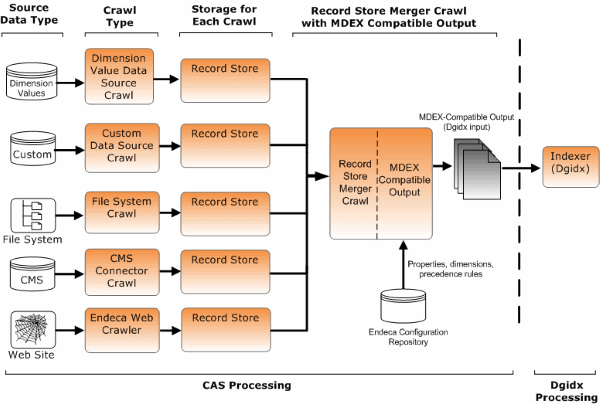

Here is a diagram of a CAS crawl that uses a Record Store Merger crawl to read from five record store instances and then write MDEX-compatible output for use by Dgidx:
