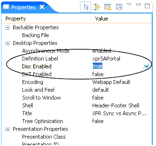

To enable Disc for a portal desktop in WorkSpace Studio, set Disc Enabled to true in the desktop Properties view, as shown in Figure 3-2.
| Note: | Enabling either Asynchronous Mode or DVT implicitly enables Disc for a desktop. |

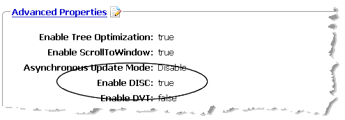

To enable Disc in the Administration Console:
| Note: | If you enable Asynchronous Mode or DVT, Disc is implicitly enabled. |
