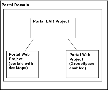

Tip:
You should have only one GroupSpace web project per enterprise application. If you create a conventional portal web project to present your desktops and portlets, do not enable GroupSpace for that project.
If you want to create custom Communities, you must create a separate portal web project that does not include GroupSpace, as illustrated in Figure 3-1.
Figure 3-1 GroupSpace Must Reside in its Own Portal Web Project
