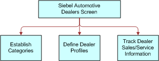

Dealer Process Workflow
The following image illustrates the end-user workflow for working with dealers, and it includes the following steps:
  • Establish Categories
  • Define Dealer Profiles
  • Track Dealer Sales/Service Information
Go to the Siebel Automotive Dealers screen to carry out each of these tasks.
Dealers Workflow: This image is described in the surrounding text.
