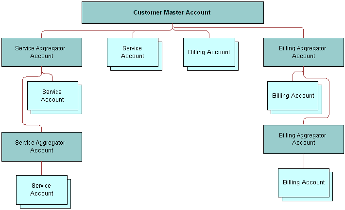

The following image shows an example of an account hierarchy in which parent-child relationships are established along service and billing account classes. In the following image, Customer Account has the following children:
  • Service Aggregator Account
    Service Aggregator Account has the following children: Service Account and Service Aggregator Account.
    Service Aggregator Account has the following child: Service Account.
  • Service Account
  • Billing Account
  • Billing Aggregator Account
    Billing Aggregator Account has the following children: Billing Account and Billing Aggregator Account.
    Billing Aggregator Account has the following child: Billing Account.
Example of Account Hierarchy: This image is described in the surrounding text.
