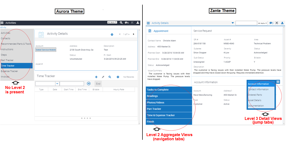

About the Siebel Mobile Aurora and Zante UI Themes
The Siebel Mobile applications for Siebel Field Service and Siebel Consumer Goods use the Zante UI theme by default, which is different from the Aurora UI theme which is the default theme used by the other Siebel Mobile applications (for Siebel Pharma, Siebel Sales, and Siebel Finance).
For information about navigating Siebel Mobile applications using the Aurora theme, see Using the Home Page for Siebel Pharma.
For information about navigating Siebel Mobile applications using the Zante theme, see Using the Home Page for Siebel Field Service.
For information about how to change the UI theme for your Siebel Mobile application, see Configuring Application Behavior Settings for Siebel Mobile.
The main difference between the Zante and Aurora themes is that the Zante theme uses second level navigation views as shown in the following image. In this image:
The Aurora theme shows the Time Tracker details for a selected activity. The complete options available for account are: Activities, Contact, Recommended Parts & Tools, Instructions, Steps, Part Tracker, Time Tracker (which is selected), Expense Tracker, and Invoices.
The Zante theme shows the Service Request details for an appointment. The following second level navigation views (or Level 2 Aggregate Views) are available for the appointment: Tasks to Complete, Readings, Photos/Videos, Part Tracker, Time & Expense Tracker, Finish. The following level 3 detail views are available for the selected service request: Account Information, Contact Information, Ordered Parts, Asset Details, Documentation.
For information about how to set up second level navigation views for your Siebel application, see Configuring Second Level Navigation Views.

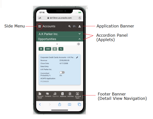

Smartphone UX for Siebel Mobile
As of Siebel CRM 20.9 Update, an enhanced Smartphone UX for smartphone devices (iOS and Android ) is available for Siebel Mobile applications.
Siebel Open UI provides a specialized PHONE theme for smartphone devices where list applets are transformed to Tile visualization mode with infinite scrolling navigation and navigation defaults to Side Menu mode. The enhanced UX for smartphone devices also employs some specialized out-of-the-box context renderers to optimize the layout (of mobile applications) on client devices to ensure the optimal usage of available real estate.
You enable the Smartphone UX for mobile applications by setting the AutoTileType component parameter to PHONE, for example, as follows:
// change param AutoTileType=PHONE for comp <application_object_manager>_<language>
change param AutoTileType=PHONE for comp ServiceMObjMgr_Enu
You must restart the component after modifying the AutoTileType component parameter for the changes to take effect on smartphone devices. Modifying the AutoTileType component parameter will not change the look and feel of the application on desktop or tablet devices.
The Smartphone UX PHONE theme for Siebel mobile applications contains the following elements, shown in the following image, and these elements persist for all views:
Application banner. This appears across the start of each page in the Smartphone UX PHONE theme and contains the following options: Side Menu, Search, Settings.
Accordion panel. This displays context information according to the selection that you make from the Side Menu and the information is displayed in accordion format. In the example shown in the following image, the accordion panel contains the following applets: Account record (for A.K. Parker Inc.) and Opportunities. You expand (or close) each applet in the accordion panel to view more (or less) information on your smartphone.
Footer banner. This displays the detail view navigation options according to the selection that you make from the Side Menu. In the example shown in the following image, Accounts is selected from the Side Menu and the footer banner contains the following detail view navigation options: Account Detail, Contacts, Opportunities, Address, Activities, and Account Team. Click Address, for example, to navigate to the address information for the selected account (A.K. Parker Inc. in this example).
The Smartphone UX feature is supported by the following Siebel Mobile applications:
You use the Behavior option under Settings to configure the application behavior for Siebel Mobile including the startup view, navigation control, UI theme, and view transition.
Startup View. The default startup view for Siebel Mobile varies according to the mobile application that you are using, but you can change the startup view as required.
Navigation Control. The default navigation control for Siebel Mobile applications is Side Menu (hamburger navigation control), but you can change this to Tab or Tree as required, provided that the control is configured for your mobile application.
Theme. The UI theme that is used by Siebel Mobile applications. You can change this to a custom theme as required, provided that a custom theme is configured for your mobile application.
Transition. The default view transition that is set for Siebel Mobile applications is None, but you can change this to a custom view transition as required, provided that a custom view transition is configured for your mobile application.
For more information about navigation control configuration, creating a new mobile theme, and creating a custom view transition for Siebel Mobile, see Configuring Siebel Open UI.

Theme
The UI theme to use throughout the application. Tap Theme, and select a theme from the drop-down list. The following themes are available:
If Side Menu is selected as the navigation control, then the following themes are available:
Aurora. This theme is used by default in the Siebel Mobile applications for Siebel Pharma, Siebel Sales, and Siebel Finance.
Zante. This theme is used by default in the Siebel Mobile applications for Siebel Field Service and Siebel Consumer Goods.
For more information, see About the Siebel Mobile Aurora and Zante UI Themes.
If Tab is selected as the navigation control, then the following themes are available: Synergy, Vanilla.
These themes are available only in the Siebel Mobile applications for Siebel Pharma, Siebel Sales, and Siebel Finance.
If Tree is selected as the navigation control, then the following theme is available: Aurora.
