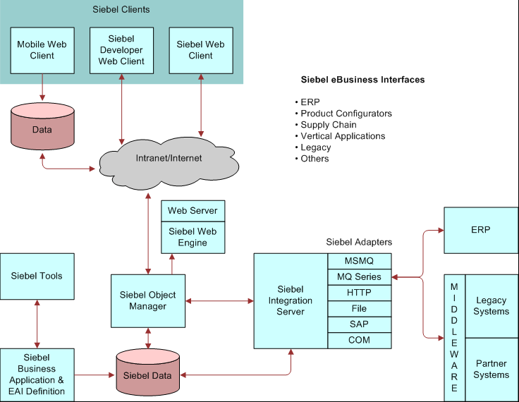

    Siebel Business Interfaces
    After you design your integration requirements for each business process flow, you can apply the different components of Siebel EAI to implement a solution. The following image illustrates the different types of applications with which Siebel Business Applications can integrate as follows:
    • Siebel eBusiness Interfaces: ERP, Product Configurators, Supply Chain, Vertical Applications, Legacy applications, Other applications.
    • Mobile Web Client, Siebel Developer Web Client, Siebel Web Client.
    • Web Server, Siebel Web Engine, Siebel Object Manager, Siebel Integration Server, Siebel Adapters (MSMQ, MQ Series, HTTP, File, SAP, COM).
    • Siebel Data, Siebel Business Application & EAI Definition, Siebel Tools.
    Siebel Business Interfaces. This image is described in the surrounding text.

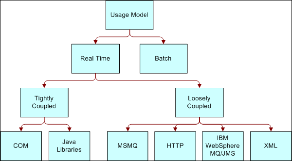

      Real-Time and Batch Mode Usage Models
      When considering your requirements, you must develop an understanding of how you intend to use the integration capabilities that are provided by Siebel EAI. You must determine how the integration behaves under specific circumstances. How are you planning to use this integration? This model is referred to as the usage model.
      The following image illustrates real-time and batch usage models. Batch mode uses a single mode, while real-time uses two modes, either tightly coupled or loosely coupled. To help you determine the appropriate usage model, answer the following questions:
      • How do I plan to integrate Siebel applications with other applications?
      • Do I need to integrate in real time, or in batch mode?
      • If I need to integrate in real time, do I need the solution to be tightly coupled or loosely coupled?
      Integration Usage Model. In this image, Usage Model has two models: Real Time and Batch. Real Time has two modes: Tightly Coupled and Loosely Coupled. Tightly Coupled is connected to COM and Java Libraries. Loosely Coupled is connected to MSMQ, HTTP, IBM WebSphere MQ/JMS and XML.

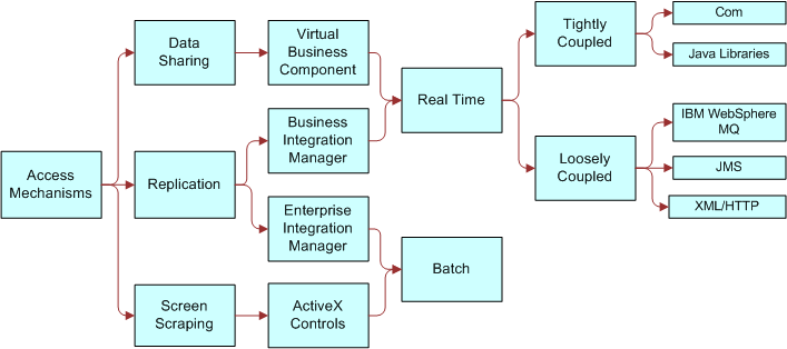

            The following image illustrates the various access options and where they fit within an integration strategy. These Siebel solutions are either real-time or batch. The access options (or mechanisms) are as follows:
            • Data Sharing, which includes the Virtual Business Component integration tool in real-time. The real-time Siebel solution can be Tightly Coupled (COM, Java Libratirs) or Loosely Coupled (IBM WebSphere MQ, JMS, XML/HTTP).
            • Replication, which includes the Business Integration Manager integration tool in real-time or the Enterprise Integration Manager integration tool in batch mode. The real-time Siebel solution can be Tightly Coupled (COM, Java Libratirs) or Loosely Coupled (IBM WebSphere MQ, JMS, XML/HTTP).
            • Screen Scraping, which includes the ActiveX Controls integration tool in batch mode.
            Siebel Solutions: This image is described in the surrounding text.
