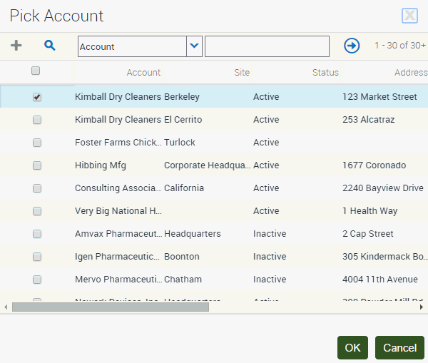

Associating Records Using a Single Selection Dialog Box
On different screens in the application, you can associate a record with an existing record or with a new record in a single selection dialog box.
The following image shows an example of a Pick Account single selection dialog box.
Example of a Single Selection Dialog Box for Pick Account: This image shows a list of accounts. The check box for the first record in the list is selected. There is an OK and a Cancel button.
Associating Records with Existing Records
Complete the procedure in this topic to associate a record with an existing record in a single selection dialog box.
To associate a record with an existing record in a single selection dialog box
  1. Navigate to the appropriate screen.
  2. Select the record you want to associate with another record.
  3. Click the single select button in the appropriate field.
    A single selection dialog box appears.
  4. In the dialog box, locate and select the record you want to associate with the existing record.
  5. Click OK.
Associating Records with New Records
Complete the procedure in this topic to associate a record with a new record in a single selection dialog box.
Note: In some situations, you cannot add new records in single selection dialog boxes.
To associate a record with a new record in a single selection dialog box
  2. Select the record you want to associate with a new record.
  4. Click New (the plus (+) icon).
    The form for the new record appears.
  5. In the form, enter the information for the new record, and click Save.
    The new record appears in the single selection dialog box, and this new record is selected.
  6. Click OK.

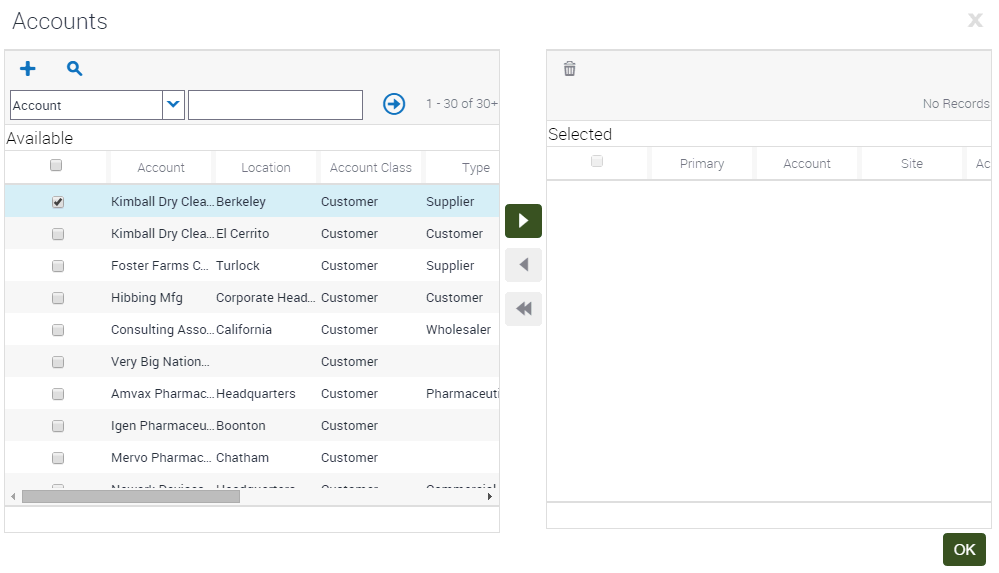

Associating Records Using a Multiple Selection Dialog Box
Multiple selection dialog boxes allow you to associate multiple records with one record. On different screens in the application, you can associate a record with an existing record or with a new record in a multiple selection dialog box.
The following image shows an example of a multiple selection dialog box for Accounts.
Example of a Multiple Selection Dialog Box for Accounts: This image contains the following elements: (1) An Available box, which contains a list of all the available accounts. (2) A Selected box, which contains a list of the selected accounts. (3) The following navigation buttons in between the Available and Selected boxes: Add, Remove, Remove All. (4) An OK button.
Complete the procedure in this topic to associate a record with an existing record in a multiple selection dialog box.
To associate a record with an existing record in a multiple selection dialog box
  2. Select the record you want to associate with other records.
  3. Click the multiple select button in the appropriate field.
    A multiple selection dialog box appears showing the list of available records and a list of selected records for the field.
  4. In the list of available records, select the record you want to associate with the current record, and then click Add to move the record to the list of selected records.
    Note: You can select multiple records by holding down the CTRL key and clicking each record. To select records that are contiguous, you can select the first record, hold down the SHIFT key, and select the last record.
  5. (Optional) To remove one or more records in the list of selected records, select the records, and then click Remove to move the records back to the list of available records.
  6. Click OK.
Complete the procedure in this topic to associate a record with a new record in a multiple selection dialog box.
If you attempt to add data to the database from a dialog box and then decide to cancel the record, then the data you add in the dialog box is not deleted from the database. However, if the data exists in the application only in the record for which you open the dialog box, then deletes the data you add in the dialog box.
Note: In some situations, you cannot add new records in multiple selection dialog boxes.
To associate a record with a new record in a multiple selection dialog box
    The new record appears in the list of selected records, and this new record is selected.
  6. Click OK.
