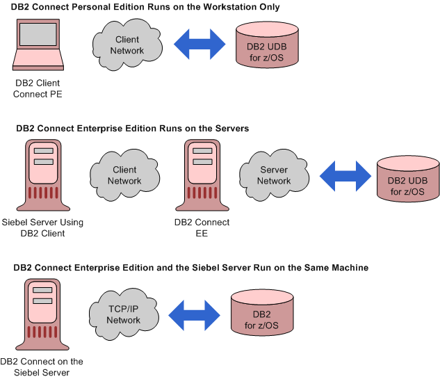

    The following figure illustrates some of the configurations possible with DB2 Connect Personal Edition (PE) and DB2 Connect Enterprise Edition (EE). DB2 Connect PE runs on the workstation only; DB2 Connect EE can run on the same computer as the Siebel Server or on a different computer. The configuration you choose largely depends on the types of Siebel clients your enterprise supports.
    DB2 Connect Enterprise Edition and Personal Edition Configurations.

      Configuring DB2 Connect EE, ASE or UE to Support Siebel Web Client
      This task is a step in Process of Setting Up DB2 Connect.
      Using DB2 Connect EE, ASE or UE to support the Siebel Web Client involves:
      • A Siebel Server, running Application Object Managers to support the Siebel Web Client. In some cases, DB2 Connect EE is also installed on this computer.
      • Optionally, an additional computer on which you install DB2 Connect EE, to act as a gateway to the database.
      • DB2 for z/OS.
      • Individual workstations running Siebel Web Client.
      This approach is illustrated in the middle and lower parts of the previous figure.
