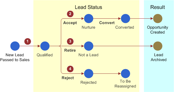

The life cycle of a lead, illustrated in the following figure, is as follows:
  1. A new lead passes from the Marketing application to Sales, where it is qualified and assigned to a sales representative.
  2. The sales representative can accept the lead and work on it (with the objective of converting it to an opportunity).
  3. The sales representative can retire the lead and archive it.
  4. The sales representative can reject the lead and reassign it to someone else.
The following figure illustrates the life cycle of a lead.
Lead Status Life Cycle. This image is described in surrounding text.
