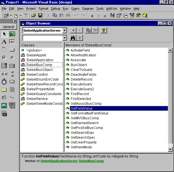

Use the object browser of your COM programming tool to determine the correct format for the object interface method.
For more information, see Example of an Object Browser.
The following image includes an example of the object browser in Microsoft Visual Basic 5.0, which is a COM programming tool. The format window at the bottom displays the method signature for the method chosen in the Object Browser window. This signature includes information about the method, such as the inputs, data types, and the information the method returns.

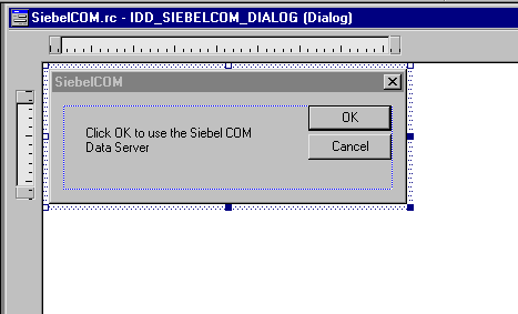

Modify the new dialog box.
Microsoft Visual C++ displays a new dialog box. To resize and modify the text in this dialog box, right-click the label in the dialog box and edit the properties. Modify the dialog box so that it resembles the following illustration.

Choose the Build menu, and then the Execute SiebelCOM.exe menu item.
Wait for Microsoft Visual C++ to display the following message:
Siebel Data Server initialized.
Click OK.
The Siebel application displays the following series of messages:
CFG file loaded. Logged in to Siebel database. Account business object returned. Account business component returned.
The Siebel application displays the name of the first account in the All Accounts view.

Start Microsoft Visual Basic.
Choose Standard EXE.
Choose the Project menu, and then the References menu item.
In the References dialog box, in the Available References window, make sure the Siebel Business Object Interfaces Type Library item contains a check mark.
To open the Object Browser, click OK.
Determine the correct format for the object interface method.
You must use the CreateObject method and the Login method. You cannot use an object interface method that returns an active Siebel object because no Siebel objects are currently active. You must use your own Siebel objects.
Verify that you can view the Siebel objects.
Add the required code.
For more information, see Example of Accessing COM Data Control.
