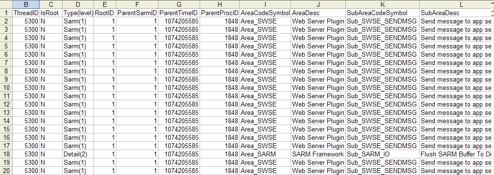

The Siebel ARM Query Tool can simultaneously write output to files in the TXT, XML and CSV formats. The following example shows using the Siebel ARM Query Tool to write different types of information to different files.
> sarmquery –input d:\sarmdata –select subarea=infra_entry –select resp=1000 –output header=hdr.csv –output sarm=sarm.csv -aggregate area –output agg=agg.xml
The preceding command writes:
Information about the header metadata from the Siebel ARM files to the file hdr.csv.
Siebel ARM data to the file sarm.csv.
Aggregate information about the area to the file agg.xml.
You can also specify a maximum number of lines to write to a file. When the file contains the maximum number of lines specified, the Siebel ARM Query Tool creates a new file with the same filename plus N, where N equals a number. The following example illustrates the use of this option:
> sarmquery –output sarm=sarmdata.csv#20000
This command writes Siebel ARM data in comma-separated values (CSV) format to the file named sarmdata.csv. The optional value #20000 writes a maximum of 20,000 lines to sarmdata.csv. Once sarmdata.csv contains 20,000 lines, the Siebel ARM Query Tool writes to a new file with the name sarmdata_0002.csv, and so on, until all of the applicable data is output.

Use the following procedure to obtain a comma-separated value (CSV) analysis output. For a description of the CSV conversion analysis and output, see About Siebel ARM to CSV Conversion Data. For more information about running the Siebel ARM Analyzer Tool, see Analyzing Siebel ARM Files Using the Siebel ARM Analyzer Tool.
To run a Siebel ARM data to CSV conversion analysis
Navigate to the
bin
subdirectory within the Siebel Server root directory.Run the Siebel ARM Analyzer Tool using one of the following commands:
sarmanalyzer -o output_file_name.csv -d csv -f sarm_file_name.sarm
where:output_file_name
.csv
is the name and path of the CSV output file.-d csv
identifies the Siebel ARM data CSV conversion analysis.sarm_file_name
.sarm
is the name and path of the binary Siebel ARM file or files.
Review the CSV output in the file named output_file_name.csv. For more information about analyzing CSV data, see About Siebel ARM to CSV Conversion Data.
Note: Running a CSV conversion can create large output files that, in some cases, cannot be read by third-party software. Use the-p
flag to split large Siebel ARM files. For more information about this flag, see About the Siebel ARM Analyzer Tool.
This topic is part of Analyzing Siebel ARM Files Using the Siebel ARM Analyzer Tool.
CSV format is a comma-separated file without any interpretation or aggregation. The CSV file contains data organized under column headers. Use third-party software tools to view this output, for example, a spread sheet. For more information about creating this format of Siebel ARM output, see Running Siebel ARM Data CSV Conversion. For a listing and description of these column headers, see the definitions of the tags for the call graph analysis in About Call Graph Generation Analysis and Data. Information can be reviewed and organized by these columns. See the following for an example of CSV data.
