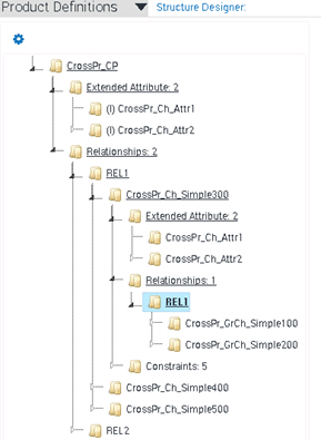

The following figure shows an example of this behavior.
This figure displays the Product Definitions Structure Designer. This is described in the surrounding text.
Consider the following constraint:
Attribute CrossPr_Ch_Attr2 = 10 requires selection of REL1 >> CrossPr_Ch_Simple300 >> REL1 >> CrossPr_GrCh_Simple100
Alternatively, if you are using Rule Assembly Language instead of configuration constraint templates, consider the following syntax:
req(==(@.[CrossPr_Ch_Attr2],AttrData("10",@.[CrossPr_Ch_Attr2])),@.[88-5B46Y]([88-5B3J5]).[88-5B4CZ]([88-5B3IC]))
Currently with the existing constraint technology, the following events occur:
If CrossPr_Ch_Attr2 =10, then both the child product CrossPr_Ch_Simple300 (Qty 1), and the grand-child product CrossPr_GrCh_Simple100 (Qty 1) are added.
However in the new Siebel Constraint Engine, constraints behave as follows:
  • If only CrossPr_Ch_Attr2 = 10, then the grand-child product CrossPr_GrCh_Simple100 is not added.
  • If both CrossPr_Ch_Attr2 = 10 and REL1 >> CrossPr_Ch_Simple300 exist, then the grand-child product CrossPr_Ch_Simple300 >> REL1 >> CrossPr_GrCh_Simple100 (Qty 1) is added.
