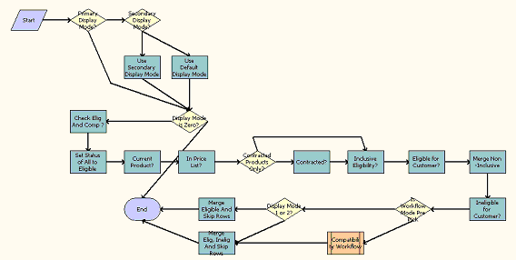

                                                      Product Eligibility & Compatibility - Default Workflow
                                                      Product Eligibility & Compatibility - Default workflow is responsible for determining the eligibility and availability of a list of inputted row set of Products. Eligibility and availability are based on eligibility rules setup in the administration views and in the procedure itself. The workflow takes a row set of Products and flags each row with an eligibility status and also a comment detailing the reason for ineligibility, if any.
                                                      This workflow is shown in the following figure.
                                                      The Product Eligibility & Compatibility - Default workflow is described in the surrounding text.
                                                      Workflow Description.
                                                      This workflow does the following:
                                                      • Primary Display Mode?. Verifies whether Primary Display Mode is specified.
                                                      • Secondary Display Mode?. Verifies whether Secondary Display Mode is specified.
                                                      • Use Secondary Display Mode. Assigns the Secondary Display Mode to the Display Mode variable.
                                                      • Use Default Display Mode. Sets Default Display Mode = 1 if both the Primary and Secondary Display Modes are not specified.
                                                      • Display Mode is Zero?. Verifies whether if Display Mode is zero and branches to the End of procedure if zero.
                                                      • Set Status of All to Eligible. Sets each Row's eligibility status to Yes. Defaults all products to eligible. Subsequent steps will flag ineligible products.
                                                      • Current Product. Verifies dates associated with the current line item. If the line item is outside of the effective dates, then sets the eligibility status to No and moves the product into the Output Set. Ensures that each product can be sold today by checking its effective from and effective to dates.
                                                      • In Price List. Searches the Price Line Item Buscomp for the product and if the product does not exist, sets eligibility status to No. Ensures that each product is in the current price list.
                                                      • Contracted Product Only. Decides whether it needs to check for contract eligibility. Checks against contracted products if the account Contracted Product Only Flag = Y.
                                                      • Contracted?. Queries for the Context Account id under Agreement BC, and verifies the start and end dates. Set eligibility status to No if no valid contracts are found. Ensures that each product appears in a pricing contract for the account.
                                                      • Inclusive Eligibility. Splits the Row Set based on the Inclusive Eligibility Flag. Only checks inclusive eligibility rules for products whose Inclusive Eligibility Flag = Y.
                                                      • Eligible for Customer. Queries the Product Eligibility BC and verifies that the row set items satisfies the eligibility requirements (Inclusive). Ensures that each product satisfies an inclusive eligibility rule (for example, that it is sold in the customer's state).
                                                      • Merge Non-Inclusive. Merges the Non-Inclusive Eligibility Row Set into the Row Set.
                                                      • InEligible for Customer. Queries the Product Eligibility BC and verifies that the row set items satisfies the eligibility requirements (non-inclusive). Ensures that no ineligibility rules are broken for each product (for example, that the product is not sold in customer's postal code).
                                                      • Is Workflow Mode Pre-Pick?. Verifies whether Workflow Mode is Pre-pick and branches to Compatibility workflow if not Pre-Pick.
                                                      • Compatibility Workflow. Executes the Product Compatibility - Default Workflow to check for compatibility of Products in Row-Set.
                                                      • Display Mode 1 or 2?. Verifies the value of the Display Mode property.
                                                      • Merge Eligible and Skip Rows. Merges Eligible and Skip Rows for Mode = 2.
                                                      • Merge Elig, Inelig and Skip Rows. Merges Eligible, Ineligible and Skip Rows for Mode = 1.

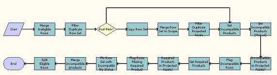

                                                        Product Compatibility - Default workflow is responsible for determining other required and excluded products for a list of inputted row set of products. It determines required and excluded products based on compatibility rules set up in the administration views. The workflow takes a row set of Products and flags each row with compatibility status and with a comment detailing related products that are either required or excluded.
                                                        The Product Compatibility - Default workflow is described in the surrounding text.
                                                        • Merge Ineligible Rows. Merges the row sets passed in by parent workflow Product Eligibility & Compatibility - Default, which already determined Eligibility of the products and separated the products into row sets depending on whether or not the products are eligible.
                                                        • Filter Duplicate Row Set. Filters out any duplicate products in the row set.
                                                        • Post-Pick?. Determines if the workflow is run in post-pick or pre-pick mode. Skips steps Copy Row Set, Merge Row Set to Scope and Filter Duplicate Projected Assets if in not in Post-Pick mode.
                                                        • Copy Row Set. Makes a copy of the unique row set created in the step Filter Duplicate Row Set.
                                                        • Merge Row Set to Scope. Merges row sets to form the scope row sets. Scope row set is all the products that the input row set will be checking Compatibility rules against. It includes the Projected Assets as well as products in the Customizable Product.
                                                        • Filter Duplicate Projected Assets. Filters any duplicate products in the Projected Assets row set.
                                                        • Get Incompatible Products. Loads A Excludes B rules for the products from the Compatibility administration view.
                                                        • Get Incompatible Products (Mutual). Load B Excludes A rules for the products.
                                                        • Incompatible Products in Projected Assets?. Checks whether there are incompatible products in the Project Asset row set based on rules retrieved in the two previous steps.
                                                        • Flag Incompatible Rows Flags rows in the Row Set with Status and Comment for incompatibilities found in the previous step.
                                                        • Get Required Products. Loads A Requires B rules for the products.
                                                        • Required Products in Projected Assets?. Checks if there are required product rule violated for products in the Project Asset row set based on rules retrieved in the previous steps.
                                                        • Flag Rows Missing Required Product. Flags rows in the Row Set with Status and Comment for missing products based on violations found in the previous step. Moves all rows with violations to the Incompatible Row Set.
                                                        • Fix Row Set with Incompatibility Status. Removes from the Row Set all the rows that exist in the Incompatible Row Set.
                                                        • Merge Incompatible products. Merges the Incompatible Row Set with the Row Set.
                                                        • Split Eligible Rows. Splits the rows with Compatibility violations from the Row Set to the Ineligible Row Set. Ineligible Row Set now contains a row set of all the products that have Eligibility violations or Compatibility violations.

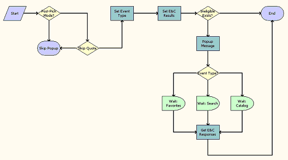

                                                          Compatibility Multiple Popup Workflow
                                                          Compatibility Multiple Popup Workflow is responsible for displaying product compatibility violations determined by the Eligibility and Compatibility workflows. This popup gives the user the option of adding the incompatible products or removing them. The popup gets triggered in Quotes and Orders unless the Skip Quote flag is set to N.
                                                          The Compatibility Multiple Popup workflow is described in the surrounding text.
                                                          • Post-Pick Mode?. Skips this workflow completely if in Pre-pick mode.
                                                          • Skip Quote. Ends this workflow if the Skip Quote flag is Y.
                                                          • Set Even Type. Stores the full event name after reading the event prefix and the event type. This event name is used later to resume the workflow.
                                                          • Ineligible Exists?. If there are no Eligibility and Compatibility (E&C) violations, goes to end of workflow
                                                          • Popup Message. Displays the popup with violating product and comment and waits for the user to decide whether to continue to add this product or to remove this product.
                                                          • Event Type?. Checks if the event for this workflow comes from Favorites, Search, or Catalog
                                                          • Wait Favorites/Search/Catalog. Waits for a resume workflow event type from one of the 3 modules.
                                                          • Loop
                                                          • Get E&C Responses. Depending on user input from previous steps, deletes or keeps products.

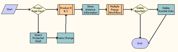

                                                              Check Eligibility & Compatibility - Default Workflow
                                                              This workflow is responsible for checking the eligibility and compatibility of a quote or order line item.
                                                              The Check Eligibility & Compatibility - Default workflow is described in the surrounding text.
                                                              • Project Asset Key?. Determines whether the Projected Asset Key is present.
                                                              • Query Projected Asset. If the Projected Asset Key is present, searches for the asset.
                                                              • Name Change. Calls the Conditional Action Transform for the Business Service Row Set Transformation Toolkit.
                                                              • Product E & C. Calls the Product Eligibility & Compatibility - Default workflow.
                                                              • Store Instance Information. Stores instance information that will be used in the Delete RowSet Data step.
                                                              • Multiple Popup Workflow. Calls the Compatibility Multiple Popup Workflow.
                                                              • Delete RowSet?. Determines whether any Line Items in the Row Set have been marked for deletion.
                                                              • Delete RowSet Data. Deletes any Line Items that are marked for deletion.
