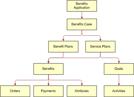

In Siebel Public Sector, the records that contain benefit data have a hierarchical relationship with each other. The following image shows this hierarchical relationship.
Details about this benefit data hierarchy follow:
A benefits application can include a benefits case.
A benefits case can include benefit plans and service plans.
A benefit plan can include benefits.
A service plan can include benefits and goals.
A benefit can include orders, payments, and attributes.
A goal can include activities.
