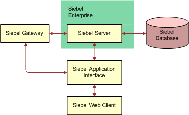

Overview of Siebel CRM Server Architecture
The following illustrates a simplified architecture for the server elements in your Siebel deployment, after you have initially installed and configured the software. For a more detailed illustration, see Siebel Deployment Planning Guide.
The Siebel CRM installation and configuration process requires multiple tasks that you perform in a general sequence that depends on your installation case. For more information, see:

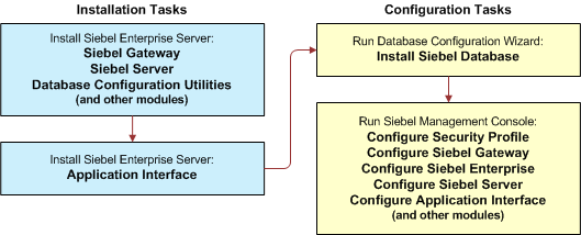

Roadmap for Installing Siebel CRM for a New Deployment
Use this roadmap to guide you in performing the installation and configuration tasks for deploying Siebel CRM, where there is no existing Siebel CRM installation and no existing Siebel database.
The following figure presents a simplified view of the installation and configuration tasks for Siebel CRM server modules for a new deployment.
Unless you use another authentication method, a Siebel database must exist before you can configure the Siebel CRM modules, in order to provide an authentication framework for the configuration tasks. You install Database Configuration Utilities with the first Siebel Server.
The installation process for Siebel CRM for a new deployment requires multiple tasks that you perform in the following general sequence:
Before performing installation and configuration tasks, review all documented requirements.
Create the network images for all applicable releases of Siebel CRM:
Create a network image for Siebel CRM 17.0.
Create a network image for Siebel CRM 20.9 Update.
For the Siebel Enterprise Server, install Siebel CRM 17.0. Then install Siebel CRM 20.9 Update. You can install the following Siebel CRM modules:
Siebel Application Interface
Siebel Gateway
Siebel Server
Database Configuration Utilities (install with the first Siebel Server)
EAI Connector (optional)
Siebel Enterprise Cache (optional)
Siebel Constraint Engine (optional, available as a developer preview)
Note: Some restrictions apply to installing Siebel CRM modules together. For more information, see About Installation Tasks for Siebel CRM.As part of installation, you also specify authentication information and port numbers that will be used by your Siebel CRM deployment. The port numbers must be unique on each installation computer or operating system instance.
(Optional) Install Siebel Gateway on additional nodes, if you will use clustering.
Verify the installation of Siebel CRM modules.
Configure the RDBMS.
Install the Siebel database.
This task installs a Siebel database for Siebel CRM. This database contains schema changes, Siebel Repositories, and seed data for Siebel CRM functionality through the current release.
Activate the license keys.
Run the Siebel Management Console and configure your Siebel deployment:
Configure a security profile.
Configure the Siebel Gateway. (Configure the primary Siebel Gateway, for a cluster environment.)
(Optional) Configure the Siebel Gateway cluster.
Configure the Siebel Enterprise.
Configure the Siebel Server.
Configure the Siebel Application Interface.
Perform any other configuration tasks that you require for your deployment.
Perform additional postinstallation tasks for the Siebel Server.

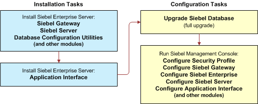

Roadmap for Installing Siebel CRM in an Upgrade Case (Existing Database)
Use this roadmap to guide you in performing the installation and configuration tasks for deploying Siebel CRM, where there is an existing Siebel database and you are upgrading from a Siebel CRM release prior to Siebel CRM 8.1.1 or 8.2.2.
The following figure presents a simplified view of the installation and configuration tasks for Siebel CRM server modules for an upgrade installation case. You install Database Configuration Utilities with the first installed Siebel Server.
This roadmap only briefly mentions the Siebel database upgrade tasks. Before you upgrade the database, you must have installed at least one Siebel Server with Database Configuration Utilities and installed Siebel Tools. For more information about upgrading, see About Installing in Upgrade Environments and see Siebel Database Upgrade Guide.
The installation process for Siebel CRM in an upgrade installation case requires multiple tasks that you perform in the following general sequence:
Siebel Gateway
Siebel Server
Note: Some restrictions apply to installing Siebel CRM modules together. For more information, see About Installation Tasks for Siebel CRM.As part of installation, also specify authentication information and port numbers that will be used by your Siebel CRM deployment. The port numbers must be unique on each installation computer or operating system instance.
(Optional) Install Siebel Gateway on additional nodes, if you will use Siebel Gateway clustering.
Upgrade the Siebel database.
See About Installing in Upgrade Environments and see Siebel Database Upgrade Guide.
