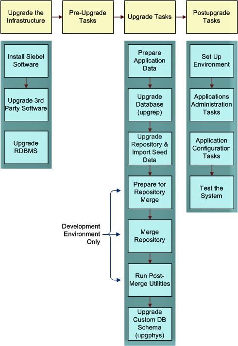

About Siebel Upgrade Environments
Upgrades: All upgrades.
Environments: All environments
This guide describes how to upgrade three database environments:
  • Development environment
  • Production test environment
  • Production environment
Detailed information on each database environment is provided in the remainder of this topic. For an overview of the steps involved in upgrading each database environment, see the chapter in Siebel Database Upgrade Guide that provides an overview of the upgrade process.

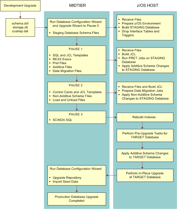

You perform the following processes in the production test environment:
  • Test the upgraded release to validate its function and performance before deploying it to users.
  • Tune the upgrade process to minimize the time required to perform your production upgrade.
Tuning the upgrade scripts can significantly reduce the time required to complete the production upgrade.

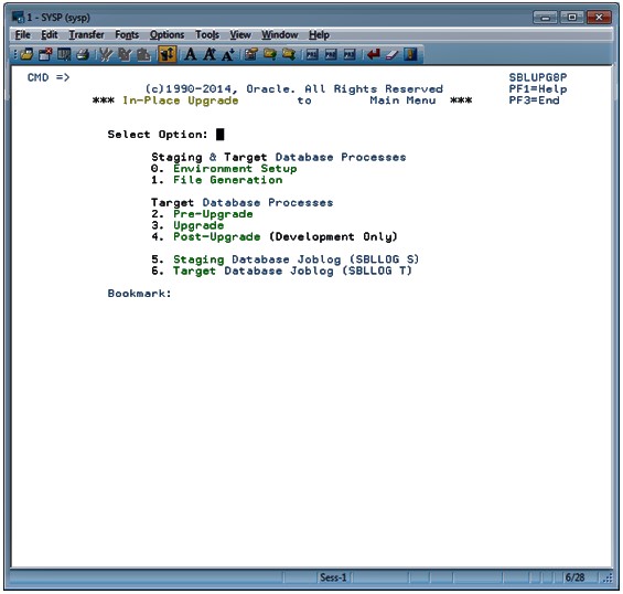

About the z/OS Upgrade
Historically, Siebel production environment upgrades were primarily performed on the z/OS host (mainframe-centric) but you could choose to upgrade your development environment using either a mainframe-centric or midtier-centric process. Since Siebel CRM 8.0, only mainframe-centric development environment upgrades are supported for DB2 for z/OS. In a mainframe-centric upgrade, all upgrade DDL statements (CREATE, DROP, ALTER, and GRANT) and DML (INSERT, UPDATE, DELETE, and SELECT) are executed on the mainframe host.
You initiate a Siebel database upgrade on DB2 for z/OS from a midtier platform (Windows or UNIX) using the Siebel Upgrade Wizard, which automatically generates the DDL and DML files necessary for the upgrade. The Siebel Upgrade Wizard is also run from the midtier to import seed data and the upgraded repository.
You must manually transfer the DDL and the data migration DML files generated on the midtier platform by the Upgrade Wizard to the DB2 host where they are unpacked and applied; this process is guided on the mainframe using REXX execs and ISPF panels. This manual portion of the upgrade, which runs directly on the z/OS host, allows you to tailor the upgrade process to suit your hardware environment and to minimize downtime. The following image shows the In-Place Upgrade Main Menu on the z/OS host.
The Siebel In-Place Upgrade Main Menu options are: 0. Environment Setup, 1. File Generation, 2. Pre-Upgrade, 3. Upgrade, 4. Post-Upgrade (Development Only), 5. Staging Database Joblog (SBLLOG S), 6. Target Database Joblog (SBLLOG T).
Each ISPF Upgrade panel has a bookmark label and message, indicating the last step completed or currently in progress. These bookmarks guide you through the upgrade process; you cannot rerun jobs that have completed successfully or run jobs out of sequence.

Flow of the Upgrade Within an Environment
The basic flow of the upgrade process is shown in the following image, and includes the following steps:
  1. Upgrade the Infrastructure
    • Install Siebel software.
    • Upgrade 3rd party software.
    • Upgrade RDBMS.
  2. Perform Preupgrade Tasks
  3. Perform Upgrade Tasks (Development Environment), Perform Upgrade Tasks (Production Test Environment)Perform Upgrade Tasks (Production Environment)
    • Prepare application data.
    • Upgrade database (upgrep)
    • Upgrade repository and import seed data.
    • Prepare for repository merge.
    • Merge repository.
    • Run post-merge utilities.
    • Upgrade custom database schema (upgphys)
  4. Perform Postupgrade Tasks
    • Set up environment.
    • Application administration tasks.
    • Application configuration tasks.
    • Test the system.
Note: In production test environment and production environment upgrades, the upgrep + upgphys steps are run together and there are several additional deployment steps.
Flow of the Upgrade Process: This image is described in the surrounding text.

To upgrade a development environment, production test environment, or production environment, you must run the Database Configuration Wizard (and Siebel Upgrade Wizard) several times, as shown in the following table.
Upgrade Step Select This Environment Type Select This Upgrade Option(s)
Development environment upgrep
Development
upgrep: zSeries Staging of Files for Upgrade
Development environmentupgrep
Development
upgrep: zSeries Seed/Repository Upgrade
Development environment upgphys
Development
upgphys
Production test environment prepare for production (7.5.3 Upgrades only)
Production
Prepare for Production Upgrade
Production test environmentupgrep + upgphys
Production
upgrep + upgphys: zSeries Staging of Files for Upgrade
Production
upgrep + upgphys: zSeries Seed/Repository Upgrade
Production environmentupgrep + upgphys
Note: If you have completed a production test upgrade and have tuned the SQL and JCL upgrade files on the z/OS host, you can use these files to perform the target database upgrade in the production environment. In this case, you do not have to run this upgrade step.
Production
Production
The following image shows how the Database Configuration Wizard (and Upgrade Wizard) work together with the Siebel Tools repository merge to upgrade your environments. The steps shown in the following image are as follows:
  1. Development Environment Upgrade:
    1. Upgrade Siebel database schema (Upgrep)
    2. Repository merge (Siebel Tools)
    3. Upgrade custom database schema (Upgphys)
  2. Merged repository and schema files from development environment are sent to production test environment.
  3. Production Test Environment Upgrade:
    1. Prepare for production
    2. Upgrade Siebel database schema (Upgrep and Upgphys)
    3. Upgrade tuning.
  4. Transition to Production.
Note: The Prepare for Production step is required for upgrades from Siebel CRM version 7.5.3 only.
Upgrade Flow: This image is described in the surrounding text.

A production database upgrade job flow, as illustrated in the following image, is largely the same as the job flow of the upgrep stage of a development database upgrade.
Flow of a Production Database Upgrade: This image is described in the surrounding text.
The main steps in the production upgrade illustrated in this image are as follows:
  1. Inputs to the Production Upgrade. The files required for the production upgrade are:
    • The storage control file (storage.ctl). This file specifies the storage layout of your upgraded database. Create and validate the storage.ctl before running a production upgrade.
    • The custrep.dat file (new customized repository) and the schema.ddl file (modified schema definition file). These files are generated during the development upgrade and must be copied to the appropriate upgrade directory before running a production upgrade.
  2. Run upgrep + upgphys. Run the Database Configuration Wizard on the midtier:
    1. Enter production environment information to create the production upgrade configuration file. Specify the following values:
      • Upgrade Option: Upgrade Siebel Database Schema (upgrep + upgphys)
      • Upgrade Process: zSeries Staging of Files for Upgrade
    2. Launch the Upgrade Wizard to generate the DDL files that will be used to build the staging database.
    The Wizard generates the staging database schema files on the midtier and then stops (Pause #0).
  3. Create the Staging Database. Transfer the staging DDL files from the midtier to the z/OS host and apply them. Create the staging database and prepare the z/OS host upgrade environment.
  4. Generate Additive Schema Upgrade Files. Restart the Database Configuration Wizard on the midtier. The wizard generates files and then stops at Pause #1.
  5. Apply Pause #1 Files. The files generated by the Upgrade Wizard on the midtier up to pause #1 consist of JCL and SQL templates and REXX execs that are run on the z/OS host against the staging database. These jobs are used to perform preupgrade tasks for the staging database. Do the following:
    1. FTP the files generated by the Upgrade Wizard from the midtier to the mainframe.
    2. Receive the files, unpack the staging data sets into PDS format, and create JCL members to run the additive schema and PRET jobs against the staging database.
    3. Apply additive schema changes to the staging database.
    4. Run PRET jobs against the staging database.
  6. Generate Nonadditive Schema Upgrade Files. Restart the Database Configuration Wizard on the midtier. The wizard generates files and then stops at Pause #2.
  7. Apply Pause # 2 Files. The files generated by the Upgrade Wizard on the midtier up to pause #2 include nonadditive schema files, load control cards and JCL templates, and unload SQL and JCL templates. Use the files generated up to this point to perform the in-place upgrade of the staging database. Do the following:
    1. FTP the files that have been generated from the midtier to the host.
    2. Modify the load and unload data sets.
    3. Run the unpack jobs to populate PDS members.
    4. Customize the UNLOAD and LOAD jobs for target tables with CLOB columns.
    5. Add jobcards and Siebel logging to the Load, Unload, and data migration jobs.
    6. Apply the nonadditive schema changes to the staging database.
    7. Create temporary tables and indexes for the data migration scripts.
    8. Generate index rebuilds.
  8. Generate the SCINDX Upgrade File. Restart the Database Configuration Wizard on the midtier. The wizard generates files and then stops at Pause #3.
  9. Apply Pause # 3 Files. The SCINDX file generated at this point is used to rebuild indexes. Do the following:
    1. FTP the SCINDX.SQL file from the midtier to the z/OS host.
    2. Apply the SCINDX.SQL file to rebuild indexes.
      This completes the file generation process
  10. Perform Pre-Upgrade Tasks for the Target Database as follows:
    1. On the z/OS host, build the JCL templates that will be used to perform the target database in-place upgrade by applying target database information to the JCL templates that were used to run the staging database in-place upgrade processes.
    2. Create and load Siebel log tables.
    3. (Optional) Apply additive schema changes.
  11. Perform the In-Place Upgrade of the Target Database as follows:
    1. Remove interface tables, triggers, and stored procedures from the database.
    2. Run PRET jobs to prepare the target database for table creation during the upgrade.
    3. Apply nonadditive schema changes to the target database.
    4. Create, bind, and test the stored procedures.
    5. Run the Data Migration jobs to migrate preexisting Siebel data to the current release.
      There are optional data migration scripts for Household data and for Siebel Financial Services (FINS) applications.
    6. Remove old indexes, create new indexes, and run index rebuild jobs.
  12. Upgrade the Repository and Import Seed Data as follows:
    1. Run the Database Configuration Wizard on the midtier.
    2. Enter production environment information to create the production upgrade configuration file. Specify the following values:
      • Upgrade Process: zSeries Seed / Repository Upgrade
    3. Launch the Upgrade Wizard. The Upgrade Wizard automatically runs the remaining DML upgrade jobs from the midtier to perform a number of tasks, including the following:
      • Deletes the old license key.
      • Verifies the repository name and imports the New Customer Repository from the upgraded development environment.
      • Upgrades seed data to the new version.
The production database upgrade is now completed.
