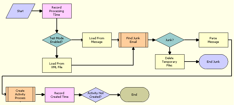

          eMail Response - Process Message Workflow
          The eMail Response - Process Message workflow processes unstructured email messages. For information about setting up the eMail Response - Process Message workflow, see Managing Workflow Processes and Subprocesses and Siebel Business Process Framework: Workflow Guide.
          This workflow is called when your organization receives an email message. The following figure illustrates this process.
          eMail Response - Process Message Workflow. This image is described in surrounding text.
          Workflow Description. This workflow performs the following actions:
          1. Record Processing Time. This step records a timestamp for the email message.
          2. Test Mode Enabled? This step examines the value of Enable Test Mode process property.
          3. Load From XML File. If the value in the Enable Test Mode process property is True, then this step loads a sample email message from a file enabling the administrator to text the workflow using the Process Simulator.
          4. Load From Message. If the value in the Enable Test Mode process property is False, then this step loads the email message from the email server.
          5. Find Junk Email. This step calls the eMail Response - Parse Junk Mail workflow to find junk email. For more information, see eMail Response - Parse Junk Mail Workflow.
          6. Junk? This step determines if the email message is junk email.
          7. Delete Temporary Files. If the email message is junk email, then this step deletes the temporary files.
          8. Parse Message. This step parses the email message for the [THREAD ID: text. For more information, see Parse Message Step.
          9. Create Activity Process. This step calls the eMail Response - Create Activity workflow to create an activity record for the email message. For more information, see eMail Response - Create Activity Workflow.
          10. Record Created Time. This step records that time that the activity record is created.
          11. Activity Not Created? This step determines if an activity record was not created.

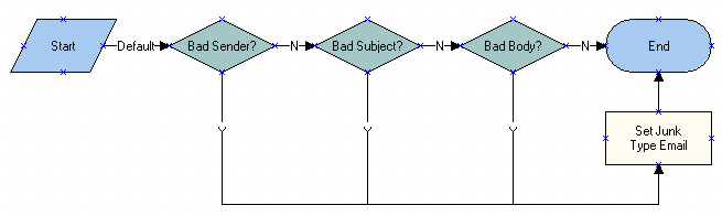

            The eMail Response - Parse Junk Email workflow finds junk email. You can configure workflows to screen out many junk email messages. A junk email message is any message that you do not want to route to an agent for processing. Administrators can define keywords in workflow decision steps that detect junk email messages. A message that is identified as junk mail is not stored in your Siebel database, and workflow processing stops.
            The Find Junk Mail step in the eMail Response - Process Message workflow calls this workflow as a subprocess. The following figure illustrates this workflow.
            eMail Response - Parse Junk Email Workflow. This image is described in surrounding text.
            1. Bad Sender? This step examines the Sender field of an email message to find keywords that the administrators specifies.
            2. Bad Subject? If no keywords are found in the Sender field of the email message, then this field examines the Subject field of the email message to find keywords that the administrator specifies.
            3. Bad Body? If no keywords are found in the Subject field of the email message, then this field examines the message body of the email message to find keywords that the administrator specifies.
            4. Set Junk Type Email. If any of the steps in this workflow find a keyword that the administrator specifies, then this step flags the message as junk email.

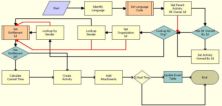

                    The eMail Response - Create Activity workflow creates activity records from inbound email messages. Agents review these activity records on the Communications screen.
                    To create activity records, the list of values for event status (EVENT_STATUS) must contain the following values at a minimum: Done, Cancelled, Queued, and In Progress. In Siebel Email Response, these minimum values and other values are included in the list of values for event status. If you inactivate any of these minimum values, then you cannot successfully create activity records.
                    The Create Activity step in the eMail Response - Process Message workflow calls this workflow as a subprocess. The following figure illustrates this workflow.
                    eMail Response - Create Activity Workflow. This image is described in surrounding text.
                    1. Identify Language. This step performs a language detection process on the email message to identify the language of the inbound email message. The language is used to route the email message to an agent with the appropriate language skills.
                    2. Set Language Code. This step sets the language code for the identified language.
                    3. Get Parent Activity SR Owner Id. This step retrieves the ID for the owner of the service request if the email message is associated with a service request. Consequently, follow-up messages can be associated with the service request.
                    4. Has SR Owned By Id. This step determines of the service request has an ID for its owner.
                    5. Set Activity Owned By Id. If the service request has an ID for its owner, then this step sets the ID for the owner of the activity.
                    6. Lookup By Org? If the service request does not have an ID for its owner, then this step determines the value in the Lookup Sender By Organization process property.
                    7. Lookup by Sender. If the value in the Lookup Sender By Organization process property is N, then this step looks for a contact that matches the email address of the sender. For more information, see Lookup Sender Step.
                    8. Get Organization Id. If the value in the Lookup Sender By Organization process property is Y, then this step identifies the organization that is associated with the email profile (mailbox) in which the message is received. If you set up multiple organizations, then you can restrict the contact lookup to a specific organization. For more information, see Configuring Communications Drivers and Profiles for Email.
                    9. Lookup Sender By Org. This step looks for a contact who is a member of the organization identified in the eMail Response - Create Activity Workflow.
                    10. Get Entitlement Id. This step calls the eMail Response - Get Entitlement Id workflow to retrieve the ID of the entitlement that is associated with the service request.
                    11. Has Entitlement Id? This step determines if the service request is associated with an ID for an entitlement.
                    12. Calculate Commit Time. If the service request is associated with an ID for an entitlement, then this step uses the entitlement to calculate the commit time for the service request.
                    13. Create Activity. This step creates an activity record for the email message.
                    14. Add Attachments. This step stores the original message and attachments as activity attachments in your Siebel database.
                    15. Is Real Time. This step determines if the activity is created in real time.
                    16. Update Event Table. This step updates the event table.

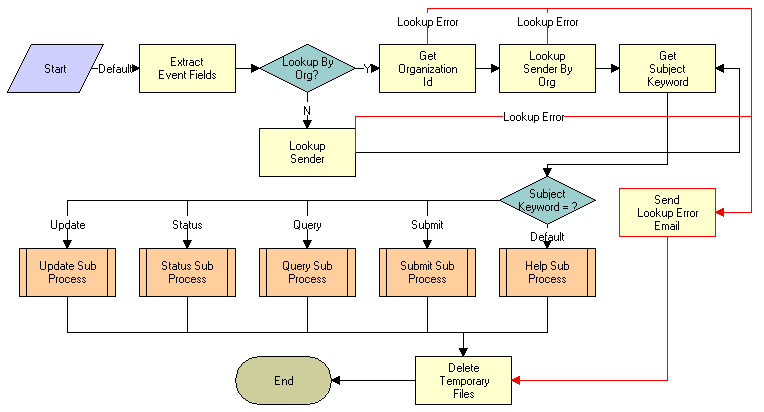

                          eMail Response - Process Service Request Workflow
                          The eMail Response - Process Service Request workflow processes structured or Web-form messages, which must be submitted in plain text. This workflow attempts to identify a contact record that matches the sender’s email address and processes the messages by identifying a keyword at the beginning of the subject line of the inbound email message. This workflow ignores the other words in the subject line. For information about setting up the eMail Response - Process Service Request workflow, see Managing Workflow Processes and Subprocesses, and Siebel Business Process Framework: Workflow Guide.
                          This workflow is called when your organization receives an email message. The following figure illustrates this workflow.
                          eMail Response - Process Service Request Workflow. This image is described in surrounding text.
                          1. Extract Event Fields. This step extracts fields from the email message.
                          2. Look Up Org? This step determines the value in the Lookup Sender By Organization process property.
                          3. Lookup Sender. If the value in the Lookup Sender By Organization process property is N, then this step looks for a contact that matches the email address of the sender. For more information, see Lookup Sender Step.
                          4. Get Organization Id. If the value in the Lookup Sender By Organization process property is Y, then this step identifies the organization that is associated with the email profile (mailbox) in which the message is received. For more information, see Configuring Communications Drivers and Profiles for Email
                          5. Lookup Sender By Org. This step looks for a contact who is a member of the organization identified in Step 4.
                          6. Send Lookup Error Email. This step sends an error email if the Lookup Sender, Get Organization Id, or Lookup Send By Org step returns a lookup error.
                          7. Get Subject Keyword. This step gets the text of the subject line of the email message and returns the first word in the subject line.
                          8. Subject Keyword =?. This step uses the subject keyword to call the appropriate Service Request (SR) subprocess.
                          9. Update Sub Process. If the subject key word is Update, then this step calls the eMail Response - SR Update workflow to update a service request record in the form of an activity associated with the service request. For more information, see Update Subprocess.
                          10. Status Sub Process. If the subject key word is Status, then this step calls the eMail Response - SR Status workflow to request the current status of the service request record. For more information, see Status Subprocess.
                          11. Query Sub Process. If the subject key word is Query, then this step calls the eMail Response - SR Query workflow to find service request records in your Siebel database. For more information, see Query Subprocess.
                          12. Submit Sub Process. If the subject key word is Submit, then this step calls the eMail Response - SR Submit workflow to create a service request record in your Siebel database. For more information, see Submit Subprocess.
                          13. Help Sub Process. If the subject key word is not Update, Status, Query, or Submit, then this step calls the eMail Response - SR Help workflow to send instructions for the supported keywords. For more information, see Help Subprocess.
                          14. Delete Temporary Files. This step deletes the temporary files.

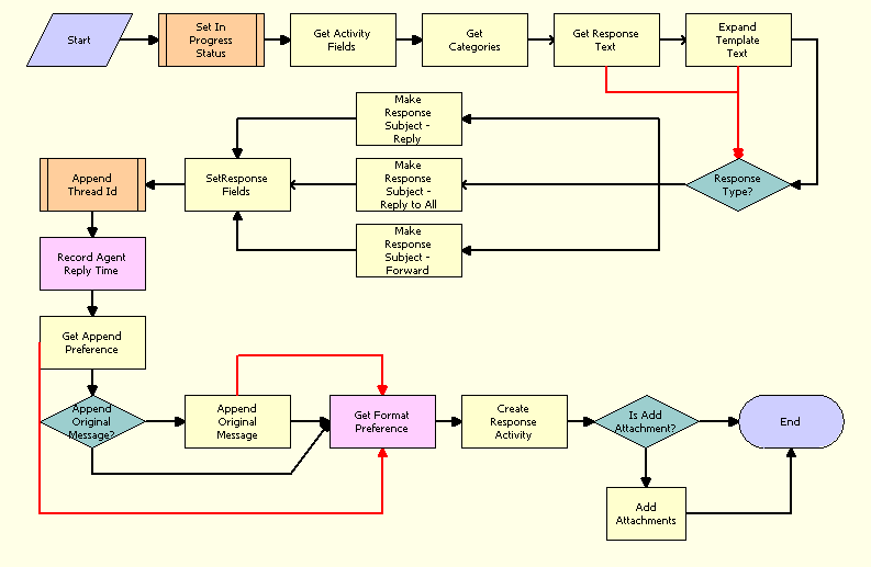

                                        eMail Response - Response Workflow
                                        The eMail Response - Response workflow creates the outbound email message and navigates agents to the view where they can compose a response message. In addition to creating the activity, this workflow also appends the original message to the bottom of the email message.
                                        This workflow is called when users click the Reply, Reply to All, and Forward buttons on the Communications screen. The following figure illustrates this workflow.
                                        eMail Response - Response Workflow. This image shows the following workflow: 1. Set In Progress Status. 2. Get Activity Fields. 3. Get Categories. 4. Get Response Text. 5. Expand Template Text. 6. Response Type? (Decision Point) 7. One of the following actions: Make Response Subject — Reply. Make Response Subject — Reply to All, or Make Response Subject — Forward. 8. SelfResponse Fields. 9. Append Thread Id. 10. Record Agent Reply Time. 11. Get Append Preference. 12. Append Original Message? (Decision point. Proceed to 13 or 14. 13. Append Original Message. 14. Set Formal Preferences. 15. Create Response Activity. 16. Is Add Attachment? (Decision point.) If Yes, proceed to 17 or 18. 17. Add Attachments. 18. End.
                                        1. It changes the activity status to In Progress.
                                        2. It retrieves the email template and returns the agent to the view where they can compose a response message.
                                        3. It generates a response based on three types: Reply, Reply to All, Forward.
                                        4. Once the message is composed, it appends the original message to the end of the email response and adds the file attachments as needed.

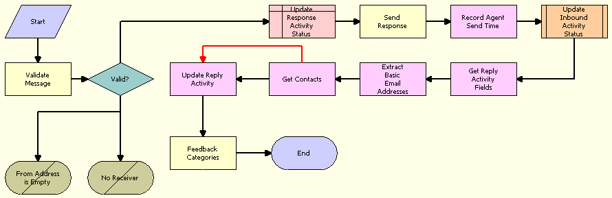

                                        eMail Response - Client Send Email Workflow
                                        The eMail Response - Client Send Email workflow performs message validation steps, updates the status of the inbound message to Done, and sends the email message.
                                        This workflow is called when users click the Send button on the Siebel Email Response Reply view. The following illustrates this workflow.
                                        eMail Response - Client Send Email Workflow. This image shows the following workflow: 1. Validate Message. 2. Valid? (Decision point.) If No, proceed to No Receiver / From Address is Empty. If Yes (valid) , go to 3. Update Response Activity Status. 4. Send Response. 5. Record Agent Send Time. 6. Update Inbound Activity Status. 7. Get Reply Activity Fields. 8. Extract Basic Email Addresses. 9. Get Contracts. 10. Update Reply Activity. 11. Feedback Categories. 12. End.
                                        1. It first validates the message sender, the message subject and message body.
                                        2. When sending out an email message, it records the agent send time and updates the inbound activity status to Done.
                                        3. It then finds the contacts based on email addresses and associates those contacts with the activity.

                                                                Setting Up Test Mode Process
                                                                After modifying the XML file, the administrator must use Siebel Tools to set up the Enable Test Mode process.
                                                                To set up the Enable Test Mode process
                                                                1. In Siebel Tools Object Explorer, select the Workflow Processes object.
                                                                2. In the Workflow Processes list, query for a process name of eMail Response - Process Message.
                                                                3. In the Workflow Processes list, select eMail Response - Process Message and then click Revise.
                                                                  The status of the workflow changes to In Progress.
                                                                4. In the WF Processes list, right-click eMail Response - Process Message and choose Edit Workflow Process.
                                                                  The Business Process Designer appears.
                                                                5. In the Workflow Process Props list, select XmlTestFileName.
                                                                6. In the Default String field, enter the complete directory path and the file name of the test XML file.
                                                                  Note: You must include the complete directory path to this file.
                                                                7. In the History Toolbar, click Back to return to Siebel Tools.
                                                                8. In the Workflow Processes list, right-click eMail Response - Process Message and choose Simulate Workflow Process.
                                                                  The Process Simulator starts.
                                                                  Setting Up Junk Mail Processing for Certain Messages
                                                                  Use the procedure in this topic to revise the eMail Response - Parse Junk Email workflow to detect messages that are sent from an email account.
                                                                  This task is a step in Process of Modifying Workflow Processes.
                                                                  To set up junk message processing for certain messages
                                                                  2. In the Workflow Processes list, query for a process name of eMail Response - Parse Junk Email.
                                                                  3. In the Workflow Processes list, select eMail Response - Parse Junk Email and then click Revise.
                                                                  4. In the Workflow Processes list, right-click eMail Response - Parse Junk Email and choose Edit Workflow Process.
                                                                  5. Right-click each decision step that you want to modify (such as Bad Sender?) and add the new value to compare with Process Property.
                                                                    For example, you can create a condition with the values in the following table.
                                                                    Compare To Operation Property Name
                                                                    Process Property
                                                                    One Must Match (Ignore Case)
                                                                    MsgSenderAddress
                                                                    In this example, the MsgSenderAddress property name is compared to Process Property. To complete this condition, enter the junk email address (for example, junk.email@example.com).
                                                                  6. In the History Toolbar, click Back to return to Siebel Tools.
                                                                  7. In the Workflow Processes list, right-click eMail Response - Parse Junk eMail and choose Validate.
                                                                    Note: For information about validating workflow processes, see Running the Process Simulator.
                                                                  8. In the Workflow Processes list, select eMail Response - Parse Junk eMail and click Deploy.
                                                                    Parsing Message Text for the Campaign ID
                                                                    You can modify the eMail Response - Process Message workflow to look for a Campaign ID field in the message body or subject. Use the procedure in this topic to complete this task. For more information, see Siebel Business Process Framework: Workflow Guide.
                                                                    When the workflow receives a message with the specified field, the text is copied into the new process property (CampaignID). Using this same approach, you can modify the eMail Response - Create Activity Process workflow and associate the activity record with the appropriate campaign.
                                                                    You can also parse an email message generated from a Web form. The Parse Message step can look for a first name, last name, and telephone number, and then use this data to create a contact record.
                                                                    To parse text for the campaign ID
                                                                    4. In the Workflow Processes list, right-click eMail Response - Process Message and choose Edit Workflow Process.
                                                                    5. Right-click the Parse Message step and choose Show Process Properties.
                                                                    6. In the WF Process Props list, add a new record with Name field of CampaignID.
                                                                    7. Right-click the Parse Message step and choose Show Input Arguments.
                                                                    8. In the Input Arguments list, add the input argument in the following table.
                                                                      Input Argument Type Value
                                                                      CampaignID
                                                                      Literal
                                                                      [CID:%s]
                                                                    9. Right-click the Parse Message step and choose Show Output Arguments.
                                                                    10. In the Output Arguments list, add the output argument in the following table.
                                                                      Property Name Type Output Argument
