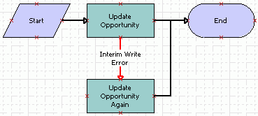

     Create a new Workflow Process with the values shown in the following table. For an example, see Creating the Workflow Process. Property Value Process Name Error Exception Example Workflow Mode Service Flow Business Object Opportunity
     Add the following steps and connectors until your Workflow Process resembles the flow shown in the following figure: -
       A Start step
       An Update Opportunity step
       An Update Opportunity Again step
       An End step
       The following Connectors:-
          A connector between step (a) and (b), (b) and (d), and (c) and (d).
          An Interim Write Error connector between step (b) and (c).

     Click the Update Opportunity business service step, and then use the Properties pane to define the properties shown in the following table. Property Value Business Service Name ABC Update Opty Business Service Method Update Opty
     With the Update Opportunity business service step selected in the Process Designer, define an input argument in the Multi Value Properties pane (MVPW) pane with the values shown in the following table. Field Value Input Argument Opportunity Id Type Process Property Property Name Object Id Property Data Type String For more information, see Arguments You Can Define for a Process Property.
     Define a decision condition on the Interim Write Error exception connector with the values shown in the following table. Property Value Compare to Process Property Operation One Must Match (Ignore Case) Object Error Code Values 0x8137 -- 0x6f74 Siebel CRM returns the 0x8137 -- 0x6f74 error code with the following error message: The selected record has been modified by another user since it was retrieved.For more information, see Creating a Decision Condition on a Branch Connector.
     Define the Update Opportunity Again business service step, using the same values you used in step 3 and step 4. For the Name property, use Update Opportunity Again.
     Validate and then simulate the Workflow Process. For more information, see Process of Testing a Workflow Process.
     Implement this configuration in your production Workflow Process.
The Update Opportunity Again step allows Siebel CRM to write to the opportunity again if the first attempt to update the opportunity fails due to the update conflict error. This example uses a business service step that updates opportunities. You can use the same configuration with other step types that update a record, such as a Siebel operation step or a sub process step, and with other types of records, such as accounts or contacts.
