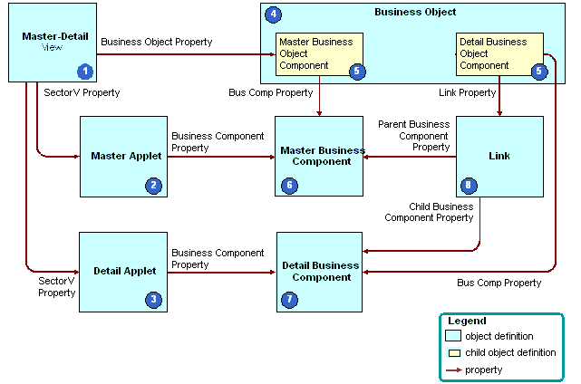

The following figure describes how Siebel CRM creates a master-detail view.
Explanation of Callouts
As shown in this figure, Siebel CRM uses the following objects to create a master-detail view:
Master-detail view. The object definition of the view.
Master applet. The form applet that displays the parent record.
Detail applet. The list applet that displays the child records.
Business object. The business object that the Business Object property of the view references. The business object creates the context that determines the active link between the business components that the applets reference.
Business object components. Child objects of the business object. Each business object component associates a business component to the business object.
Master business component. The business component that the parent applet references.
Detail business component. The business component that the detail applet references.
Link. The link that specifies the parent-child relationship that exists between the parent business component and the child business component. The Link property of the detail business object component identifies the link.
