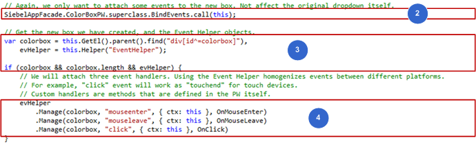

The following figure illustrates the code you use to customize the BindEvents method of the plug-in wrapper. Each number in this figure identifies the corresponding step number in the numbered task list that this book includes immediately after this figure.

                              In the colorboxpw.js file, introduce the BindEvents method that is a part of the life cycle of rendering a control. ColorBoxPW.prototype.BindEvents = function () {
                              Call the superclass method to attach the event handlers from the dropdown element: SiebelAppFacade.ColorBoxPW.superclass.BindEvents.call(this);This step calls the BindEvents of the DropDownPW class, which is responsible for attaching the events that the drop down field requires to operate correctly.
                              Get the element that was created and attached as a sibling to the actual dropdown element, and the Event Helper object: var colorbox = this.GetEl().parent().find("div[id^=colorbox]"), evHelper = this.Helper("EventHelper"); if (colorbox && colorbox.length && evHelper) {The Helper API is the framework method in the plug-in wrapper space that enables retrieving helper objects by name. For more information about the Helper API, see Architecture of Siebel Open UI.
                              Attach the required events to the new DOM element that was created. In this example, three handlers are attached to one element: evHelper .Manage(colorbox, "mouseenter", { ctx: this }, OnMouseEnter) .Manage(colorbox, "mouseleave", { ctx: this }, OnMouseLeave) .Manage(colorbox, "click", { ctx: this }, OnClick)The Helper API is a method in the Event Helper object that takes the following four elements: the DOM element to which events should be attached, the event to be attached, the handler to be run, and other arguments. In this case, you are attaching one event for the each user hovering over the element, exiting the hover, and clicking on the element. For more information about the Helper API, see Architecture of Siebel Open UI.
