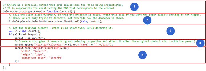

The following figure illustrates the code you use to customize the ShowUI method of the plug-in wrapper. Each number in this figure identifies the corresponding step number in the numbered task list that this book includes immediately after this figure.

     In the colorboxpw.js file, introduce the ShowUI method that is a part of the life cycle of rendering a control. ColorBoxPW.prototype.ShowUI = function (control) {
     Call the superclass method to get the dropdown to appear: SiebelAppFacade.ColorBoxPW.superclass.ShowUI.call(this, control);This will call the ShowUI method of the DropDownPW class, which is responsible for showing the drop down field in the Siebel Open UI client.
     Get a reference to the existing element, and if it exists, get the parent element: var el = this.GetEl(); if (el && el.length) { parent = el.parent();Note: This step is required to position the new DOM element as a sibling to the current element.The GetEl() API framework method is a plug-in wrapper space that retrieves the jQuery element representing the control. parent() is a jQuery call which retrieves the parent node of the element in the DOM. For more information about the GetEl() API method, see Architecture of Siebel Open UI.
     Add a new HTML div, which will serve as our color box: parent.append("<div id='colorbox_" + el.attr("name") + "' ></div>");You must specify a unique name for the element. In this example, colorbox_is added to the existing name of the original element. Theappend()andattr()specifications are both jQuery APIs. The former adds DOM elements at the end of a given element and the latter extracts the specified attribute.
     Style the newly created div. This will serve as our colorbox: parent.find("div[id^=colorbox]").css({ "width": "inherit", "height": "20px", "background-color": "inherit" });The css()is a JQuery API that applies CSS styles to the given element. In this example, the colorbox gets the same width as the original dropdown and a height of 20 pixels. The original background color is inherited from the dropdown.
     Save the ColorBoxPW.js file.
