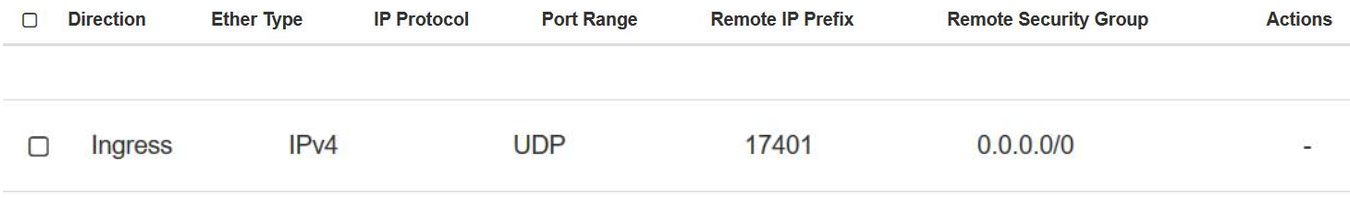

tcpdump -i eth1 -n "host noam00-17badf67-imi or noam01-17badf67-imi and port 17401 and udp" - If ping request or response packets are not coming
from any server, then add security group rule ingress (response) or egress (request)
to that instance.
The following image shows Ingress response:
Figure 22-1 Ingress Response
