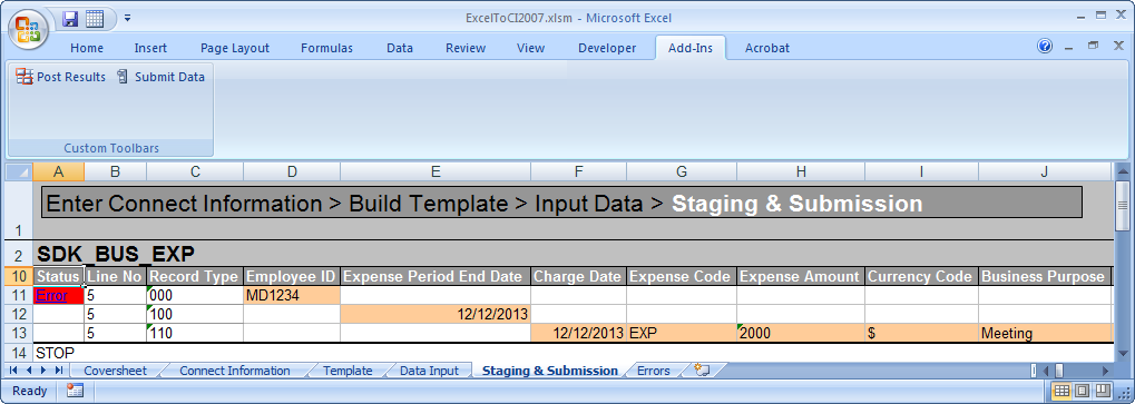

Viewing the Staged Data
Access the Staging and Submission tab:
Image: Staging & Submission tab in Excel to Component Interface Utility
This example illustrates the Staging and Submission tab of the Excel to Component Interface utility.
Staging and Submission Actions Toolbar

After you submit the data to the database, the result of entering the data into Excel to Component Interface utility appears on the Staging and Submission sheet. If a submission generates an error or a warning, the Status column in the Staging and Submission sheet displays that.
You can read the errors and warnings messages on moving your cursor over the Status column. Also, the utility adds an Errors page which displays consolidated error messages with the respective row numbers.
If you click a cell that displays Error link in the Status column, an HTML page opens. This HTML page also displays the complete list of error and warning messages in a tabular format.
Both the Errors sheet and the HTML page help to display all error messages and warnings on a single sheet. You can correct the input data before staging it for submission to the database again. You can continue this process of correcting errors and resubmitting the data until no errors remain.

Submission Statuses
Errors received for each record submitted appear in a comment field when you move the cursor over the status column. The records marked OK in green have been successfully submitted and cannot be restaged for submission and can be kept as a record of work completed.
One of the following three status values can appear when you submit data to the database:
Field or Control |
Definition |
Ok |
The submission to the database finished successfully. The field is highlighted in green. These records cannot be restaged for submission. |
Warning |
The data was saved to the database successfully, but a warning was generated in the process. The field is highlighted in yellow. |
Error |
The data was not saved to the database due to an error. This field is highlighted in red with a hyperlink to a HTML page. The field provides two options to see the error details that the component interface generated.
Note: The same errors are also consolidated in the Errors worksheet in the Excel to Component Interface utility. |
