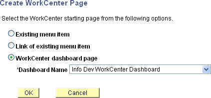

    The Create WorkCenter Page page is displayed:
    Image: Create WorkCenter Page page
    This example illustrates the fields and controls on the Create WorkCenter Page page:
  3. On the Create WorkCenter Page page, select the type of starting page:
    • Existing menu item – Select this option to convert an existing content reference into a WorkCenter.
      Important! When users navigate to the menu item for this content reference, they will now open the WorkCenter once it is converted in this manner.
    • Link of existing menu item – Select this option to create a link to an existing content reference. The link will be used as the WorkCenter starting page.
      Note: When users navigate to the menu item for this content reference, they will continue to open the content, and not the WorkCenter.
    • WorkCenter dashboard page – Select this option to use an existing WorkCenter dashboard page as the WorkCenter’s starting page.
      Note: When no WorkCenter dashboards exist in the system, this option is not displayed. In addition, the Dashboard Name field is displayed only after you select this option.
