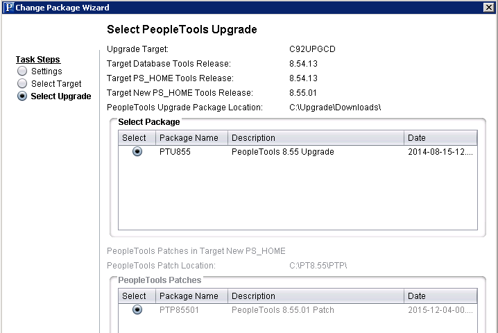

Select PeopleTools Upgrade
The select PeopleTools Upgrade page will display the target database information, as well as the change package to install and any PeopleTools patches that Required at Upgrade and downloaded to the download directory.
Image: Select PeopleTools Upgrade
This example illustrates the fields and controls on the Select PeopleTools Upgrade page.

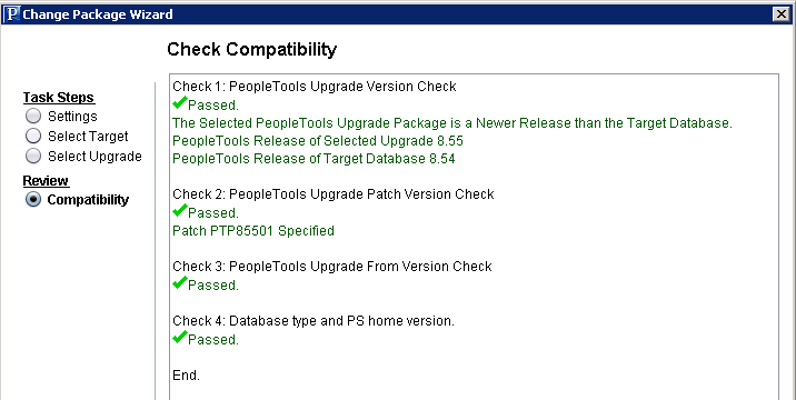

Check Compatibility
Change Assistant will perform a compatibility check to the upgrade version and upgrade patch.
Image: Check Compatibility
This example illustrates the fields and controls on the Check Compatibility.
