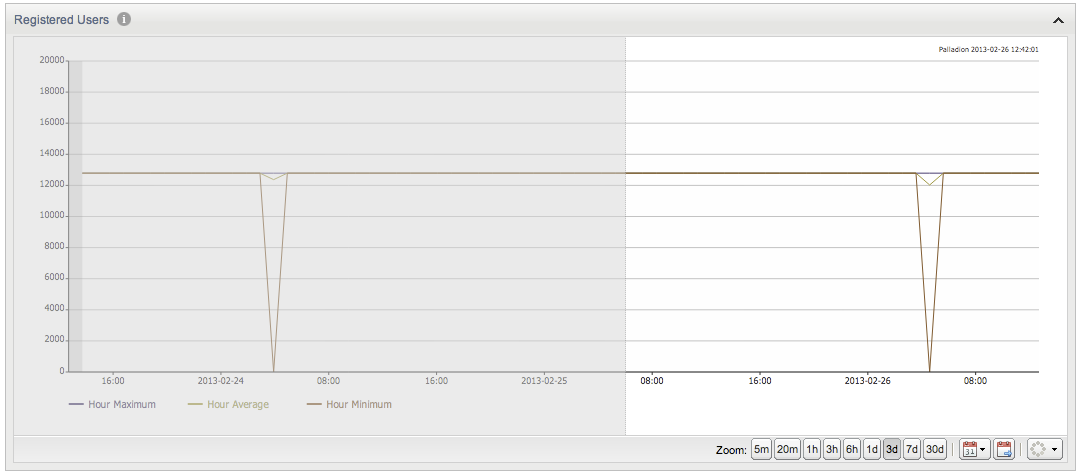

Registered Users Panel
The top panel contains a chart that traces the total number of registered users over time. The sampling interval is 1 minute for drawing the sample's minimum, maximum, and average values.
By default, a window of three hours is presented. The time frame can be adjusted and the chart allows for panning. For more information on using charts, see " Charts ".
Figure 4-51 Registered Users Panel While Dragging Time Window
Description of "Figure 4-51 Registered Users Panel While Dragging Time Window"
If Operations Monitor has no registration information over a period of time (due to factors like recent start up, downtime, or lack of traffic), that interval is indicated in the chart by a gray area (as seen on the left side of Figure 4-51).

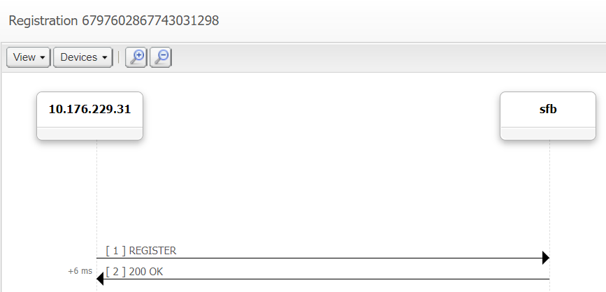

Click the Message flow button to open a SIP message flow diagram window that depicts the network entities involved and message exchange of the registration event.

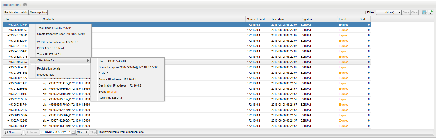

Many of these actions are available by right-clicking (see Figure 4-52).
Right-Click Contextual Menu
Right-click menu actions are as follows:
Filter table for ... allows you to filter for:
Other registration events of the same user or contact.
The same code or event type.
All registrations involving the same address or device.
WHOIS information for ... allows you to inquire who is the owner of the IP used as the source of the registration. A window appears that contains the record stored into the WHOIS database for the given address.
Create trace with user ... loads the Traces page with the User field pre-filled with the value taken from the corresponding registration event.
Track user ... loads the User Tracking page with the User field pre-filled in the search panel taken from the event.

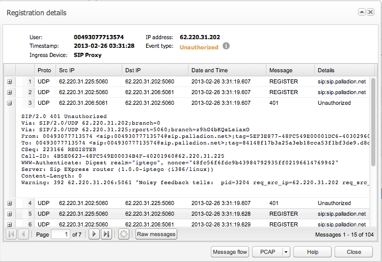

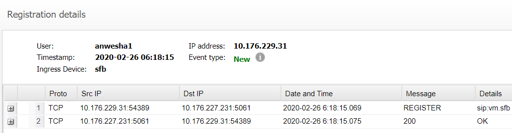

Registration Details
The details window for a registration event contains the following information:
The user of full AOR (subjected to settings).
The timestamp when the event occurred.
The network entity of the platform having received the registration request (the ingress device).
The IP address used to originate the requests.
The type of registration event.
A table that contains details about the exchanged messages in this event, listed in chronological order.
Table 4-10 lists the columns in Registration Details window.
Table 4-10 Registration Details Window

Registration Details Actions
Click the Raw messages button to view the raw SIP message as seen on the network. You can click the button again to display brief messages.
You can view one raw message at a time by double-clicking on any of the table's entries, as shown in Figure 4-55.
Figure 4-55 Registration Details Window with One Expanded Raw Message
Description of "Figure 4-55 Registration Details Window with One Expanded Raw Message"
Beside the Help and Close buttons, the details window contains a Message flow button and a PCAP button. The Message flow button creates a SIP message flow diagram, and the PCAP button allows you to save the shown network packets into a PCAP file.
