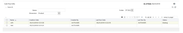

Figure 1: Cash Flow Edit Summary page
Description of Cash Flow Edit Summary page as follows
