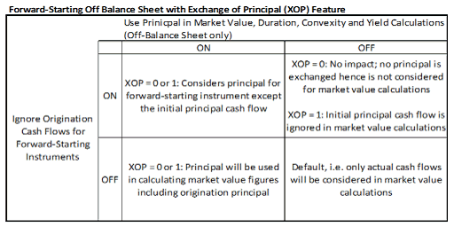

You can ignore the "initial principal amount on forward-starting instruments" if required.This helps you to origination principal to be considered in the calculation of market value and their exposure derivatives (e.g. duration, convexity, YTM, etc).
This allows you to decide to consider the initial origination cash flows for forward-starting instruments in the calculation of market value and exposure derivatives. If you select "initial principal amount on forward-starting instruments"check-box in Discount Method UI, then CFE will ignore the first (origination) principal cash flow on a forward-starting instrument in the calculation of market value and exposure derivatives.

2. Future Originations Adjustment
Instruments that originate after a designated start date can be included in the market value for that start date if the issue date is less than or equal to the start date. In this case, the negative flow of funds on the origination date is considered to be a cash flow for discounting purposes.
In the case of Bonds with Embedded Options, forward Starting Instruments would have a change while calculating the market value (MV) for determining the exercisability of the option. The initial cash flow outlay would not be part of the market value calculation. Because including the initial cash flow outflow while calculating the market value significantly reduces the MV. And the 'in the moneyness' comparison would not make sense.
For all forward-starting instruments, you can specify that origination cash flows be ignored for market value and exposure derivatives calculations. This is a product-level rule established in Discount Methods – Cash Flow Definition Details.
For more information, see the Oracle Financial Asset Liability Management User Guide.
Off-Balance Sheet Derivatives with Exchange of Principal Feature
Generally, off-balance-sheet derivative instruments do not have principal cash flows. However, certain OBS instruments may specify that the principal is exchanged at the data level (EXCHANGE_OF_PRINCIPAL = 1). If the Exchange of Principal flag is enabled, then all corresponding market value and exposure derivative figures reflect this.
Else, you can specify that the cash flow engine considers the impact of the principal in market value calculations, even if it is not exchanged. This is a product-level rule established in Discount Methods – Cash Flow Definition Details.
In the special case of a forward-starting derivative that also features the exchange of principal feature, the following specifies how the cash flow engine with handle each exception:
