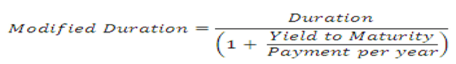

The DURATION_C column holds the calculated Macaulay Duration output.
Both the Static Deterministic and Dynamic Deterministic ALM processes will calculate and output Macaulay Duration when the Market Value option is selected from the Calculation Elements block. This result is written to FSI_O_RESULT_MASTER and FSI_O_CONSOLIDATED_MASTER tables for each scenario defined in Forecast Rates. Additionally, users can choose to update the instrument data with Macaulay Duration for each record if the related option is selected on the Output Preferences block. Each instrument record will be updated for scenario 1 result only.
The cash flow engine calculates the duration using the following formula:
Description of the Modified Duration formula follows

Calculated by ALM Deterministic Processes (optionally), this output field represents the modified duration.
Both the Static Deterministic and Dynamic Deterministic ALM processes will calculate and output Modified Duration when the Market Value option is selected from the Calculation Elements block. This result is written to FSI_O_RESULT_MASTER and FSI_O_CONSOLIDATED_MASTER tables for each scenario defined in Forecast Rates. Additionally, users can choose to update the instrument data with Modified Duration for each record if the related option is selected on the Output Preferences block. The instrument record will be updated for scenario 1 result only.
The cash flow engine calculates the modified duration using the following formula:
