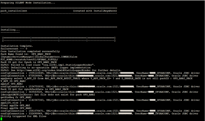

6.     The OFS AAI installation begins.
Figure 24: OFS AAI Installation
This illustration shows installation of the OFSAAI Application Pack in the SILENT mode.
Data Model Upload may take several hours to complete.
7.     The OFSAA Infrastructure installation performs a post-install check automatically on the successful installation of the product.
Figure 25: Installation In Progress
This illustration shows installation of the OFS BSP Pack in the SILENT mode.
Congratulations! Your installation is complete.
Figure 29: OFS AAI Installation
Figure 30: Installation In Progress
