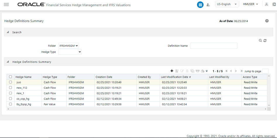

You can access the Hedge Definitions section by clicking the Hedge Definitions link present under the Hedge Management menu in the LHS of the OFS HM application. Upon clicking this link, the Hedge Definitions Summary page is displayed with a list of all the existing definitions.
Figure 11: The Hedge Definition Summary pane
These definitions are listed with the details such as Hedge Name, Hedge Type, Folder, Creation Date, Created By, Last Modification Date, and Last Modified By.
You can search for existing definitions using the search parameters such as Folder, Definition Name, or Hedge Type and by clicking the Search button. On performing a search operation, only those definitions that match with the search criteria are displayed in the Hedge Definitions grid.

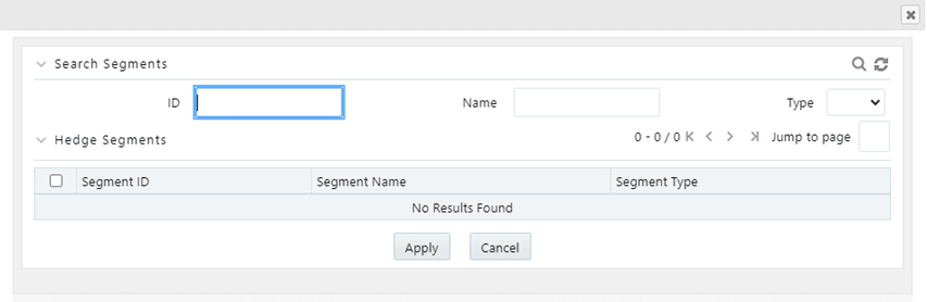

1. Click the Add button from the Hedged Items grid to open the Hedge Segments window appears with the list of existing Hedge Segments. Here you can search for segments using ID, Name, and/or Type.
Figure 13: The Segments window
2. Select the checkbox adjacent to the Segment ID of the Hedge Segment you want to select and click the Apply button.
The selected segments are displayed with the details such as Segment ID, Segment Name, and Segment Type.
