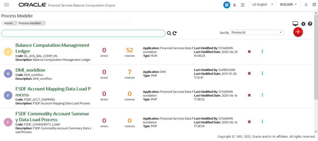

1. From OFSAA Home, select the Financial Services Balance Computation Engine, then select Orchestration, select Process Modeler. The Process Modeler page is displayed.
Figure 24: Navigate to the Process Modeler page
2. In the Process Modeler page, click

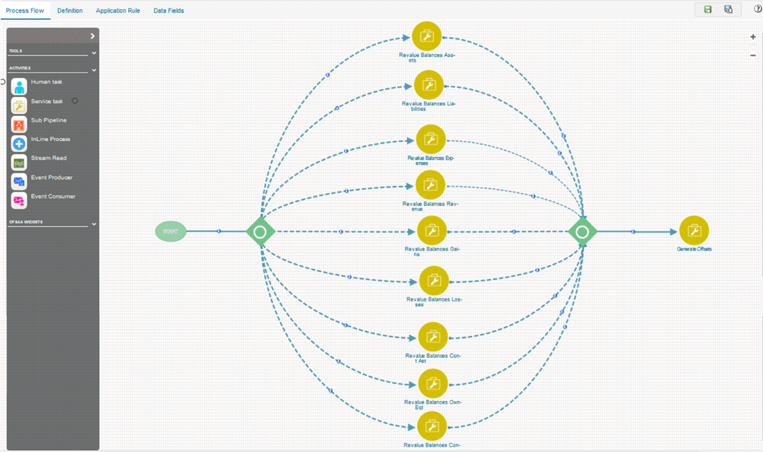

5. In the Process Flow designing page, design a Revaluation Process flow Run pipeline using the floating toolbar and a drawing canvas. Use the drawing canvas to design the process flow with the Tools, Activities, and OFSAA Widgets components available in the floating toolbar with Service Task as the base. In the illustration, each Service Task represents GL type for Assets, Liabilities, Expenses, Revenue, Gains, Losses, Contra Asset, Contra Liability, and Owner’s Equity set in the Revaluation Settings section.
For more information, see the Service Tasks section in the Oracle Financial Services Analytical Applications Infrastructure Process Modelling Framework Orchestration Guide Release 8.1.0.0.0.
Figure 26: Creation of Balance Revaluation Management Ledger process flow
6. Save the Revaluation Process Flow.

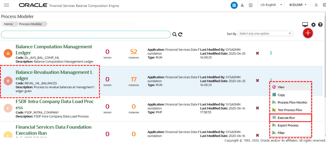

7. The Revaluation Process is listed in the Process Modeler page. To select the Run parameters and execute the Run, follow these steps:
a. In the Process Modeler page, click
corresponding
to the Revaluation Process Run Pipeline that must be executed.
Figure 27: Balance Revaluation Management Ledger process - Select Execute Run

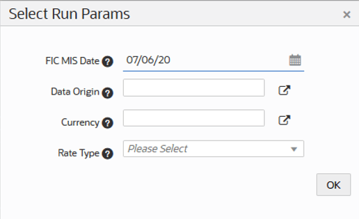

8. When you click Execute Run, the Select Run Params page is displayed.
Figure 28: Balance Revaluation Management Ledger process - Select Run Params page
Select the required values for each field as follows.
NOTE |
The values are fetched from the FSI_EXCG_RATES and SETUP_MASTER tables. |
Table 4: Balance Revaluation Management Ledger process - Select Run Params page field names and description
Field Name |
Description/Instruction |
FIC MIS Date |
Use the |
Data Origin |
Use the |
Currency |
Use the |
Rate Type |
Select the Rate Type from the drop-down list. The options are as follows: · Average · Daily · End of Period |

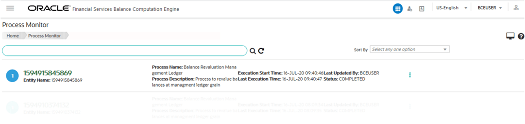

b. The Process Monitor page is displayed listing all the Run instances corresponding to the Balance Revaluation Management Ledger process. In the Process Monitor page, search by Process ID, or by the Process Name Balance Revaluation Management Ledger, and select the process instance for the required Run pipeline (process) that was executed.
Figure 29: Balance Revaluation Management Ledger process – Process Monitor page – select Process ID
11. A status is displayed, which shows the execution status of the executed Run for the Balance Revaluation Management Ledger process. In this illustration, the Run for the Revaluation is successfully executed.
Figure 30: Balance Revaluation Management Ledger process – Run Execution status
