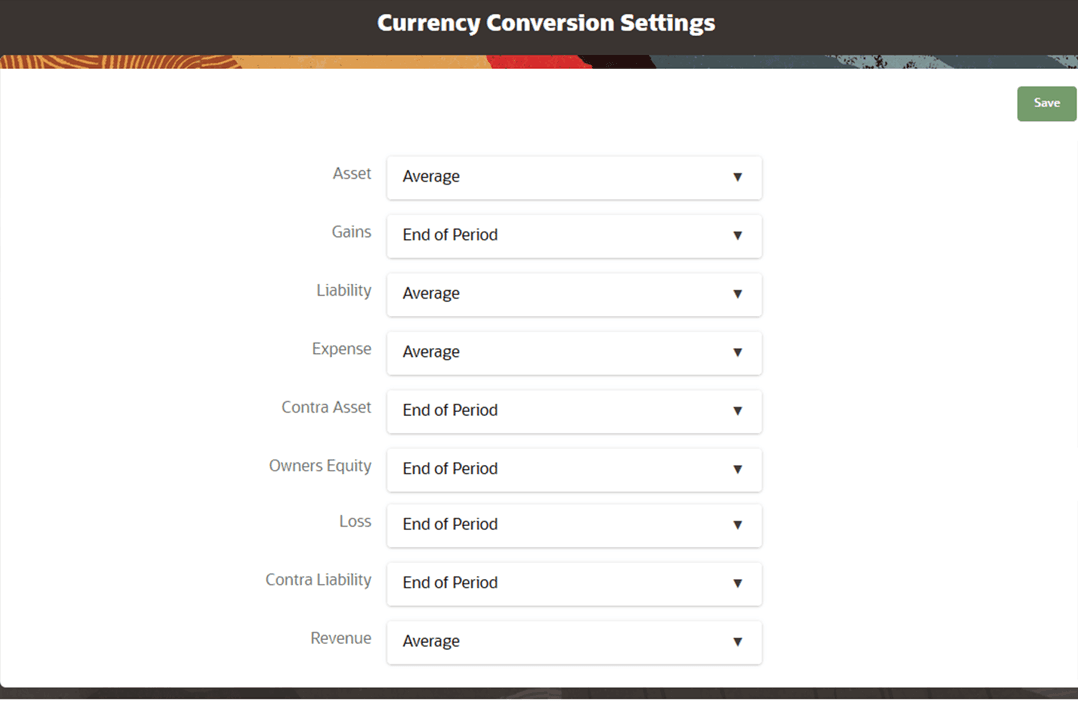

Currency Conversion Settings
Setup the currency conversion settings to assign the Rate Type to a GL Type, which is required during the Execution process in PMF.
To setup the currency conversion settings, follow these steps:

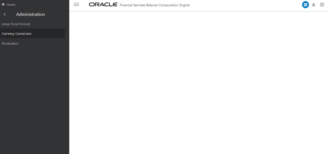

1.     From OFSBCE Home, select Financial Services Balance Computation Engine. In the Navigation List, select Currency Conversion.The Currency Conversion Settings page is displayed.
Figure 10: Navigation to Currency Conversion
2.     Select the required value for each entity.
Figure 11: Currency Conversion Settings Page
Select the End of Period, Daily or Average Rate Type for the following GL type entities:
§       Asset
§       Gains
§       Liability
§       Expense
§       Contra Asset
§       Owners Equity
§       Loss
§       Contra Liability
§       Revenue
3.     Click Save to save the currency conversion settings.

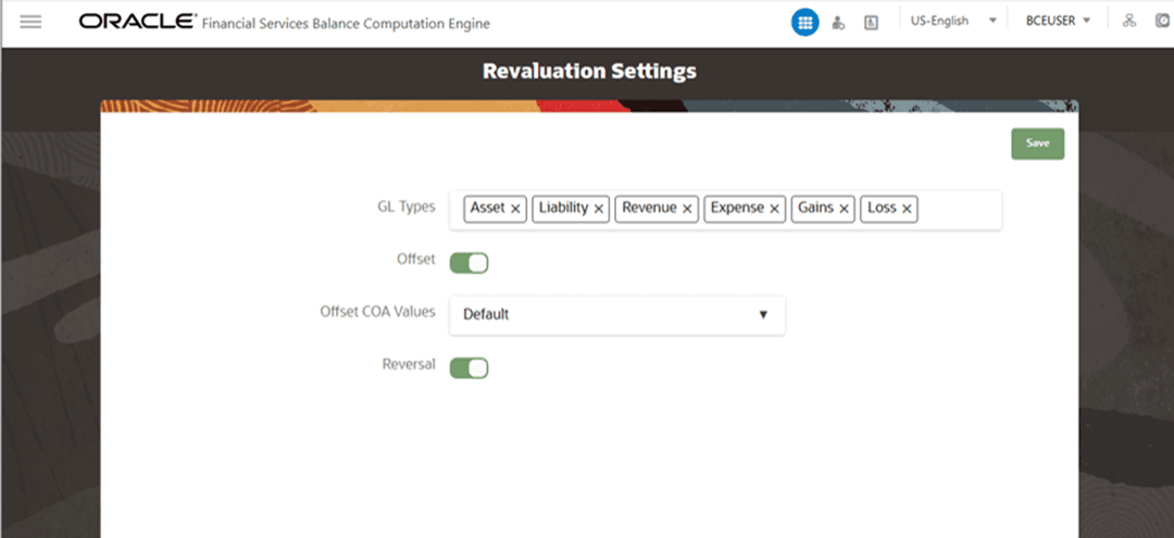

Revaluation Settings
The Revaluation Process reads the following setup information during the process execution. To setup the Revaluation Settings, follow these steps:

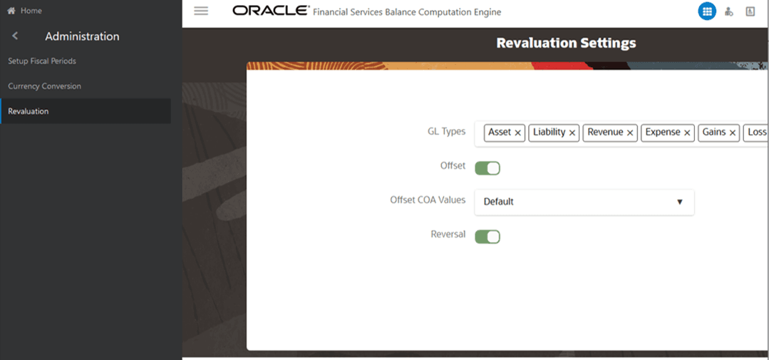

1.     From OFSBCE Home, select Financial Services Balance Computation Engine. In the Navigation List, select Revaluation. The Revaluation Settings page is displayed.
Figure 12: Navigation to Revaluation Settings
2.     In the Revaluation Settings page, set the following values. These settings affect the design and execution part of the Revaluation Process in the PMF.
Figure 13: Revaluation Settings Page
Table 1: Revaluation Settings entities and their description
Entity
Description
GL Types
The General Ledger types of those journal entries, which must be considered during the Revaluation Process.
Offset
Select this option if you must generate the offset balances against the Revalution Adjustments for equivalents.
Offset COA Values
Order the Offset Chart of Account values either by the Default value or System value.
System: Instrument gain is a part of the output of the offset entries. Every calculation is done at the Management Ledger Gain level including the instrument account. Then in the Revaluation process execution stage, for each account in the Management Ledger Period Balances, the offset balance is generated.
Default: When the Offset COA Values are set to Default, the system generates the offset balances at the Legal Entity grain.
Reversal
Select this option if you want to revise the Revaluation for period balances by reversing the prior period adjustments and adding current period adjustments.
3.     Click Save to save the Revaluation settings.
