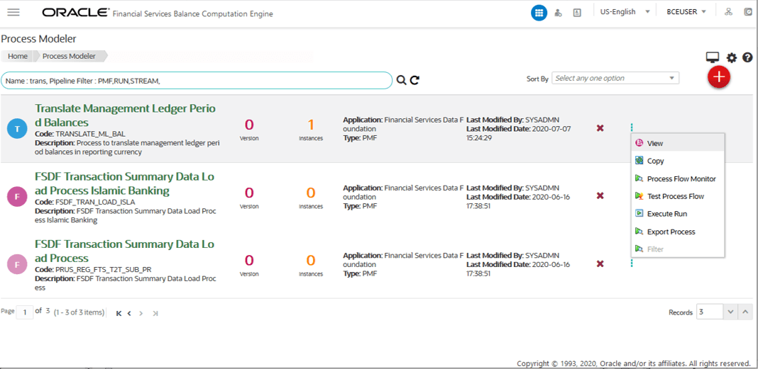

1.     From OFSAA Home, select Financial Services Balance Computation Engine, select Orchestration, and then select Process Modeller. The Process Modeler page is displayed.
Figure 31: Process Modeler page
2.     In the Process Modeler page, click

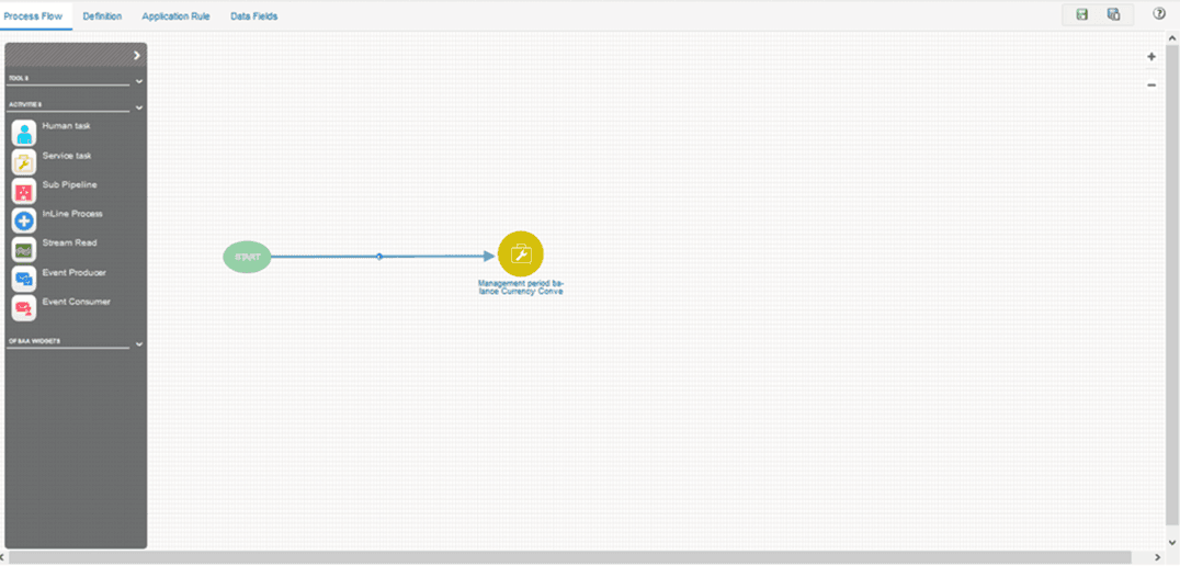

4.     To save the details and launch the Process Flow designing page, click Save And Launch.

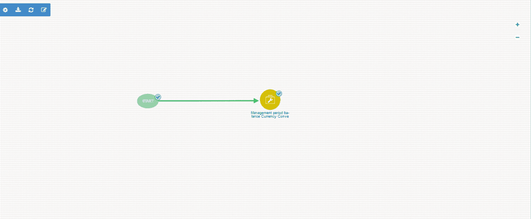

5.     In the Process Flow designing page, design a Currency Translation Process flow Run pipeline using the floating toolbar and a drawing canvas. Use the drawing canvas to design the process flow with the Tools, Activities, and OFSAA Widgets components available in the floating toolbar with Service Task as the base. In the illustration, the Service Task represents GL type for Management Period Balance Currency Conversion set in the Currency Conversion Settings section.
NOTE
To create an Application Rule, see the Application Rules section, and to create a Data Field, see the Data Fields section in the Oracle Financial Services Analytical Applications Infrastructure Process Modelling Framework Orchestration Guide Release 8.1.0.0.0.
Figure 33: Creation of Translate Management Ledger Period Balances process flow
For more information, see the Service Tasks section in the Oracle Financial Services Analytical Applications Infrastructure Process Modelling Framework Orchestration Guide Release 8.1.0.0.0.
6.     Save the Currency Translation Process flow.
7.     The Currency Translation Process is listed in the Process Modeler page. To select the Run parameters and execute the Run, follow these steps:
a.     In the Process Modeler page, click  corresponding to the Translation Process Run Pipeline that must be executed.
Figure 34: Translate Management Ledger Period Balances process - Select Execute Run

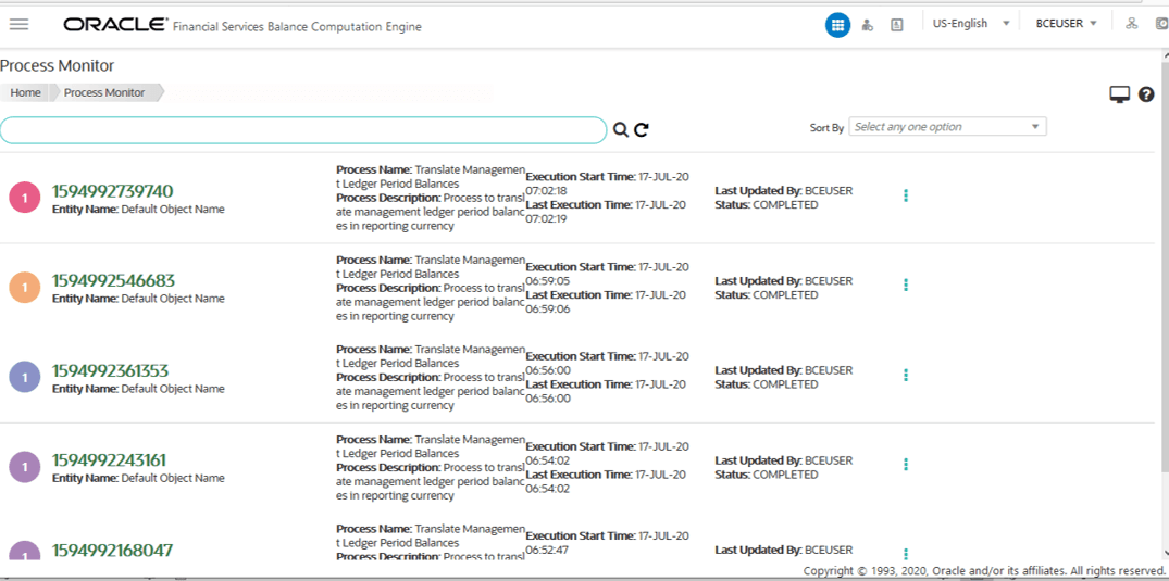

10.  To open the Process Monitor page, in the Process Modeler page, click the  icon or select Process Flow Monitor from the .
11.  The Process Monitor page opens displaying all the Run instances corresponding to the Translate Management Ledger Period Balances process. Or, in the Process Monitor page, search by Process ID, or by the Process Name Translate Management Ledger Period Balances, and select the process instance for the required Run pipeline (process) that was executed to verify the status and logs.
Figure 36: Translate Management Ledger Period Balances process - Process Monitor page - select Process ID
12.  In the illustration, the Run pipeline is successfully executed. Therefore, the Currency Translation process is successfully complete and all the balances selected for the Translation are converted into the set Reporting Currency.
Figure 37: Translate Management Ledger Period Balances process - Run Execution status
For detailed information about the complete functioning of the PMF, see the Oracle Financial Services Analytical Applications Infrastructure Process Modelling Framework Orchestration Guide Release 8.1.0.0.0.
