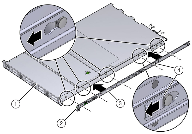

Perform the following procedure to install mounting brackets onto the sides of the server.
Position a mounting bracket against the chassis so that the slide-rail lock is at the server front, and the five keyhole openings on the mounting bracket are aligned with the five locating pins on the side of the chassis. See Figure 6.3.
Table 6.3 Figure Legend
Item
Description
1
Chassis front
2
Slide-rail lock
3
Mounting bracket
4
Mounting bracket clip
With the heads of the five chassis locating pins protruding through the five keyhole openings in the mounting bracket, pull the mounting bracket toward the front of the chassis until the mounting bracket clip locks into place with an audible click.
Verify that the rear locating pin has engaged the mounting bracket clip.
Repeat these steps to install the remaining mounting bracket on the other side of the server.

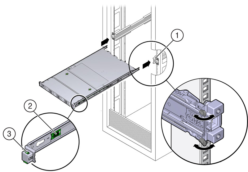

Push the slide-rails as far as possible into the slide-rail assemblies in the rack.
Position the server so that the rear ends of the mounting brackets are aligned with the slide-rail assemblies that are mounted in the rack. See Figure 6.6.
Insert the mounting brackets into the slide-rails, and then push the server into the rack until the mounting brackets encounter the slide-rail stops (approximately 30 cm, or 12 inches).
Table 6.5 Figure Legend
Item
Description
1
Inserting mounting bracket into slide-rail
2
Slide-rail release button
3
Slide-rail lock
Simultaneously push and hold the green slide-rail release buttons on each mounting bracket while you push the server into the rack. Continue pushing the server into the rack until the slide-rail locks (on the front of the mounting brackets) engage the slide-rail assemblies. See Figure 6.7.
You will hear an audible click.

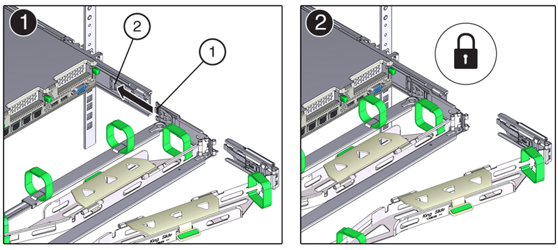

Insert the CMA's connector A into the front slot on the left slide-rail until it locks into place with an audible click. See Figure 6.8, frames 1 and 2.
The connector A tab (see call-out 1) goes into the slide-rail's front slot (call-out 2).
Gently tug on the left side of the front slide bar to verify that connector A is properly seated.
Insert the CMA's connector B into the front slot on the right slide-rail until it locks into place with an audible click. See Figure 6.9, frames 1 and 2.
The connector B tab (call-out 1) goes into the slide-rail front slot (call-out 2).
Gently tug on the right side of the front slide bar to verify that connector B is properly seated.

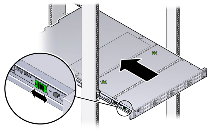

Simultaneously pull and hold the two green release tabs (one on each side of the server) toward the front of the server (see the following figure) while you push the server into the rack. As you push the server into the rack, verify that the CMA retracts without binding. See Figure 6.13.
NoteTo pull the green release tabs, place your finger in the center of each tab, not on the end, and apply pressure as you pull the tab toward the front of the server.
Continue pushing the server into the rack until the slide-rail locks (on the front of the server) engage the slide-rail assemblies.
You will hear an audible click when the server is in the normal rack position.

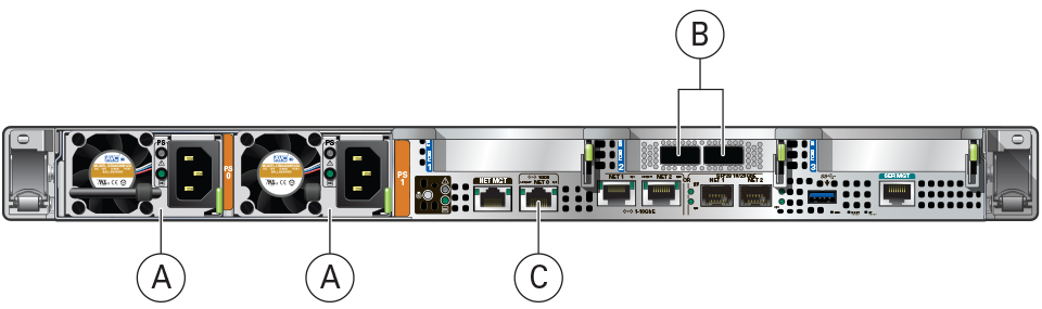

Connect the pre-installed power and data cables of the appropriate rack unit to the back of the expansion node. The cables are labeled for your convenience, and should be connected according to Figure 6.14.
Table 6.9 Figure Legend
Item
Description
A
Power supplies
B
Ethernet QSFP28 connectors
C

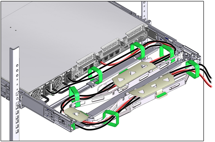

NET0Ethernet portOpen the CMA cable covers, route server cables through the CMA's cable troughs, close the cable covers, and secure the cables with the six Velcro straps. See Figure 6.15.
First through the front-most cable trough.
Then through the small cable trough.
Then through the rear-most cable trough.
NoteWhen securing the cables with the Velcro straps located on the front slide bar, ensure that the Velcro straps do not wrap around the bottom of the slide bar; otherwise, expansion and contraction of the slide bar might be hindered when the server is extended from the rack and returned to the rack.
Ensure that the secured cables do no extend above the top or below the bottom of the server to which they are attached; otherwise, the cables might snag on other equipment installed in the rack when the server is extended from the rack or returned to the rack.
NoteIf necessary, bundle the cables with additional Velcro straps to ensure that they stay clear of other equipment. If you need to install additional Velcro straps, wrap the straps around the cables only, not around any of the CMA components; otherwise, expansion and contraction of the CMA slide bars might be hindered when the server is extended from the rack and returned to the rack.

Simultaneously pull and hold the two green release tabs (one on each side of the server) toward the front of the server while you push the server into the rack. See Figure 6.13.
Verify that the CMA retracts without binding.

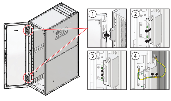

Perform the following procedure to replace the rack front and rear doors:
Lift the door into place, and align the pins on the door with the sleeve on the cabinet (1).
On the top hinge, rotate the two studs on the hinge away from the center of the hinge (2). The pins snap into place (3). Do the same with the bottom hinge.
Repeat these steps to reinstall the other rack doors.
Reconnect all grounding straps on all doors (4).
Close the doors. Optionally, lock the doors.
These steps are illustrated in Figure 6.1.
The doors are heavy. Have one person hold the door in place while the other operates the hinge latching mechanism. Execute the steps carefully and in the correct order, to avoid damage to the hinges.
Table 6.10 Figure Legend
Item | Description |
1 | Lifting the door into place. |
2 | Rotating the hinge studs away from the center. |
3 | Pins on the latching mechanism snap into place. |
4 | Attaching the grounding cables. |
